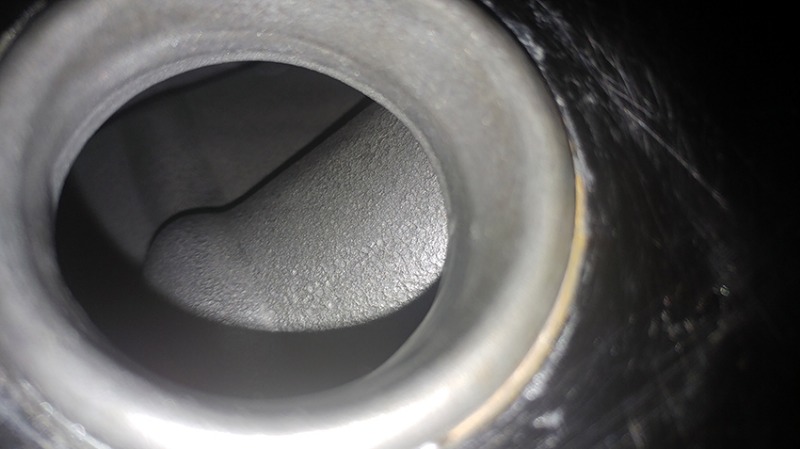

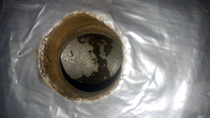

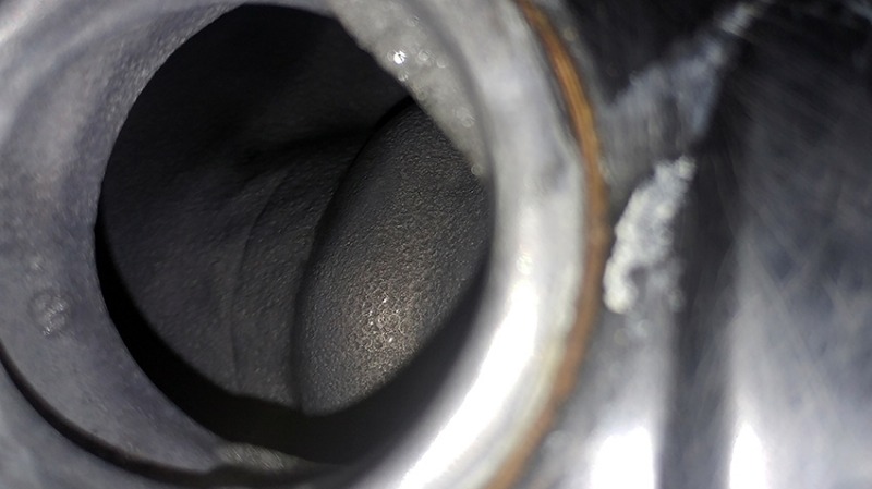

The fuel tank came out really nice. It was covered with rust inside and looked hopeless. That has changed and it's like new now, sealed for eternity. The process was a long one, but the final results leave no regrets.
There were many steps, many repetitions. Here's how it went.
The initial rust removal was done with regular straight white vinegar and 2 pounds of nails. Rinsing with water (shower head hose in a bathtub) and baking soda to neutralize the acidic environment.
It's unbelievable how soon and fast the tank covers with rust after removing the vinegar and rinsing it! It's called flash rust and very superficial. But if left alone too long, it grows and the tank has to be cleaned again. It's all surface then, so a much easier task.
After the initial cheap cleaning with vinegar, I used POR-15 cleaning solution. I had to use the nails again because some of the flash rust build up didn't come off in all places (I left the tank sit for a couple weeks after the vinegar treatment). With some shaking, the inside turned out spotlessly clean and rust free.
Next step was POR-15 metal prep solution. It etches the surface and introduces some Zinc.
The tank has to be completely dry after this - I used a hair dryer and took my time.
Clean but some minute flash rust just minutes after drying the tank.

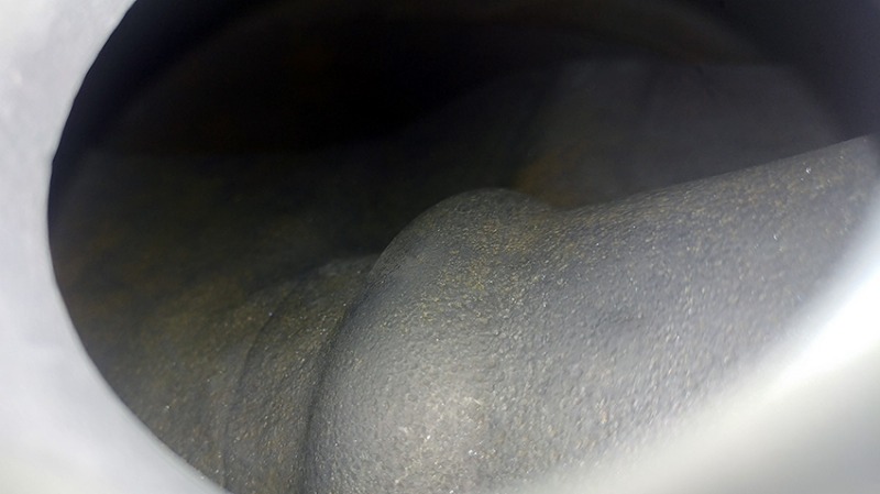

After prep solution treatment before rinsing.
The last - POR-15 tank sealant. Poured it in, sealed with duct tape, move around to make sure the compound seals everything inside. Drained and let it sit to dry. It's quite a stink at first, I had to move it around but most of the time it stayed locked in the bathroom. The smell goes gradually away, and you can't smell it after five days.
The tank is sealed and ready for gasoline. It just needs a paint job, and that it will get. POR-15 sealant is extremely durable. You can't remove it. I am very happy with it and if I need to treat another tank, that's what I will use. They should pay me for my endorsement, hahaha

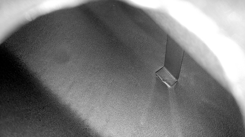

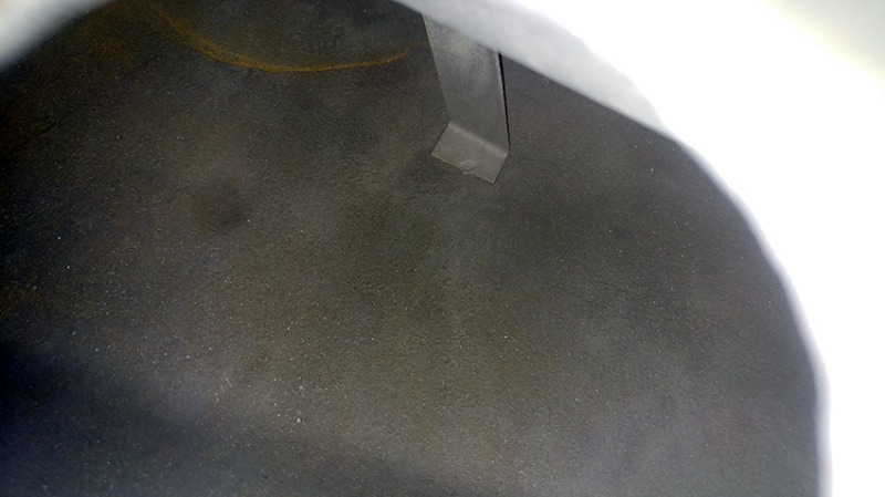

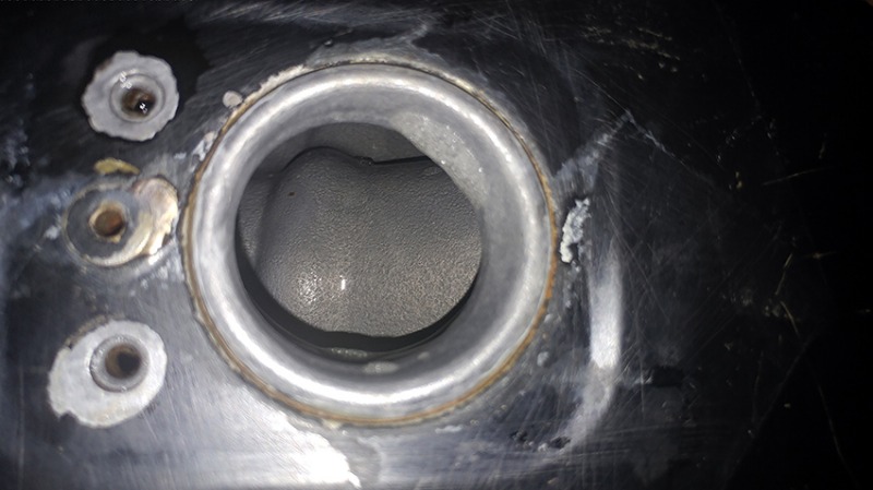

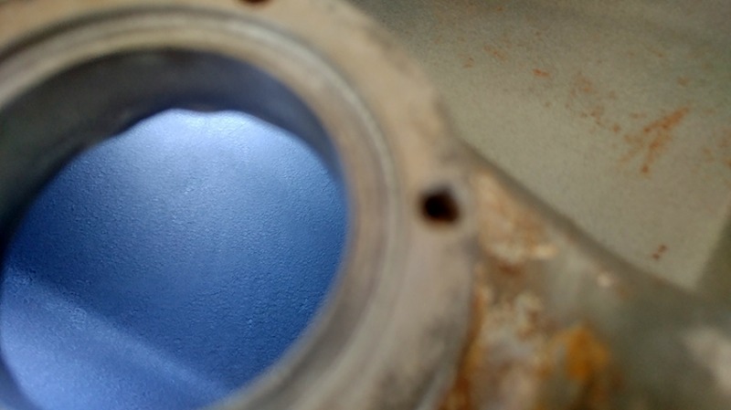

Few pictures of the sealed inside gas tank. It's a thin but very durable layer, hugging every corner and imperfection. POR-15 instructions say that it can be poured over any flash rust and will seal pinholes and any small leaks, and whatever rust is left (which is neutralized after the treatment). But I decided to have the tank completely stripped from any rust. That's the way to go in my opinion. First use vinegar, as it is cheap, then the POR-15 solutions to finish the job properly.
