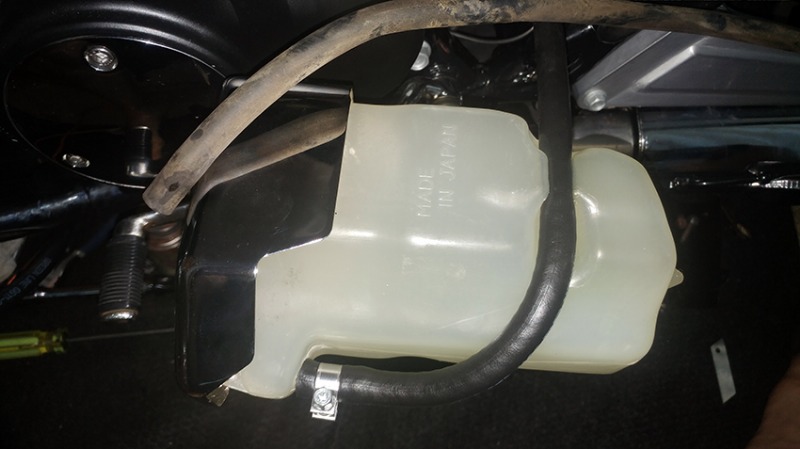

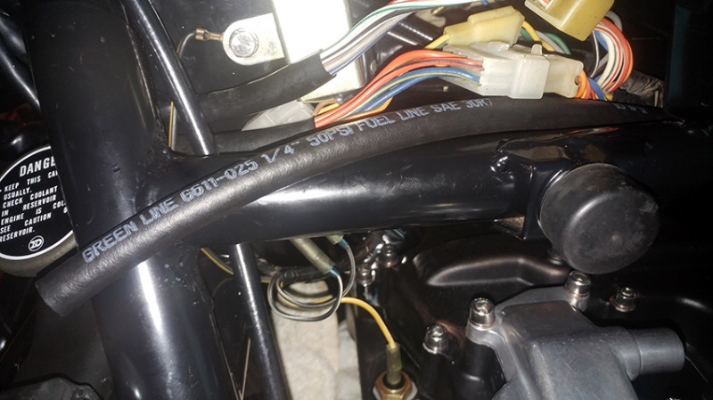

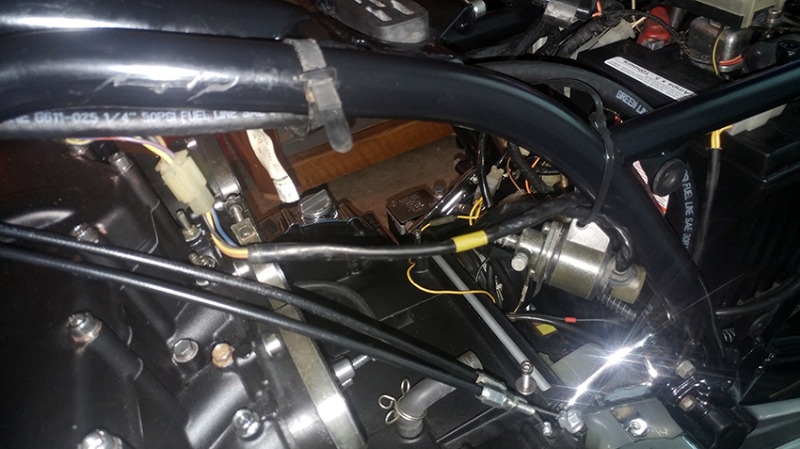

I have asked about it before so I owe and explanation how I have done it.
The original hose is dirty but overall fine except for one small split on the end. I just used a brand new 1/4" fuel line, which externally is very close in diameter to the original.
I will decide if I run it above or below the main frame after installing the coils - I just want to make things neat.
It's not permanently attached yet. I will use plastic ties for it. But that when installing the air boxes.
Last edit: 8 years 1 month ago by StanG.

IN the first picture above in my post the hose clamp goes 180 degrees the other way - otherwise the frame will be in the way to push the reserve tank in.
