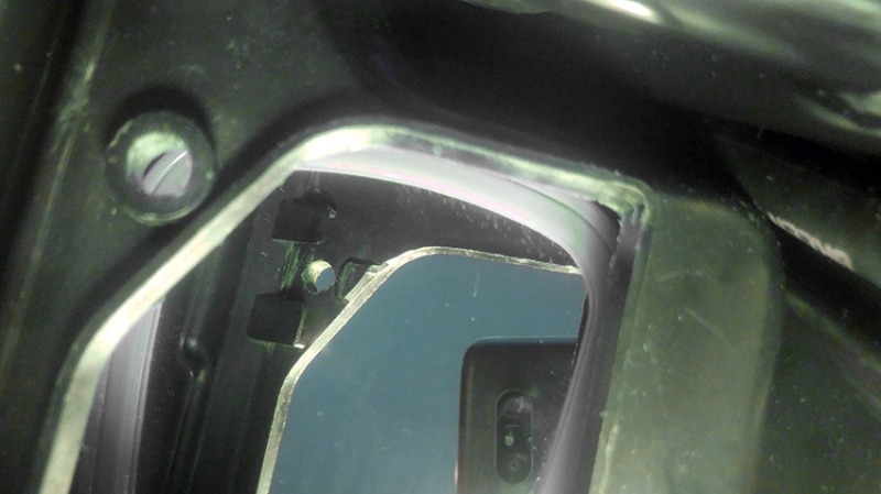

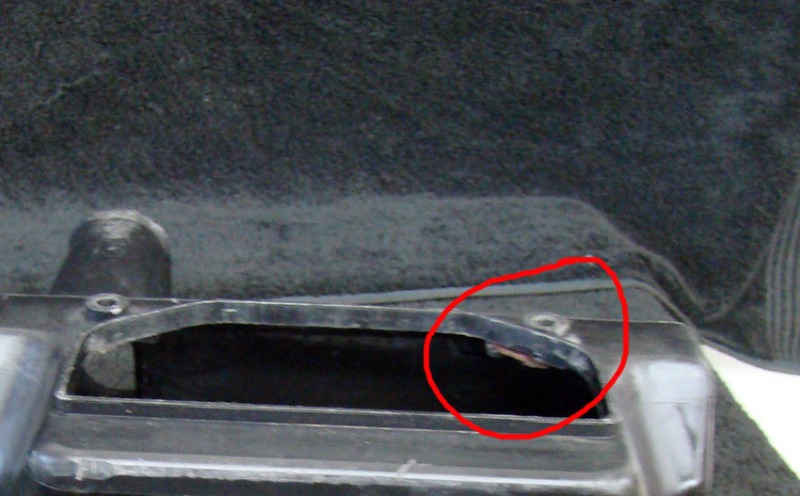

Just found this photo on the internet and 'borrowed' a part of it. I see what's going on there.
And a photo of mine. Why these are missing?? Someone went through a lot of trouble JUST to take them out! Didn't expect this and why didn't I use a mirror sooner..
Now, I have to find a couple that will match.

If I remember correctly there is a threaded captive nut in each of those two holes, to accept a bolt. And I believe the OEM bolt was a Philips-head if you wan t to stay authentic.

They were likely deliberately removed The captive nuts(?) were probably rusted/seized and just rotated within the retainer along with the screw. That would explain why they're missing.
