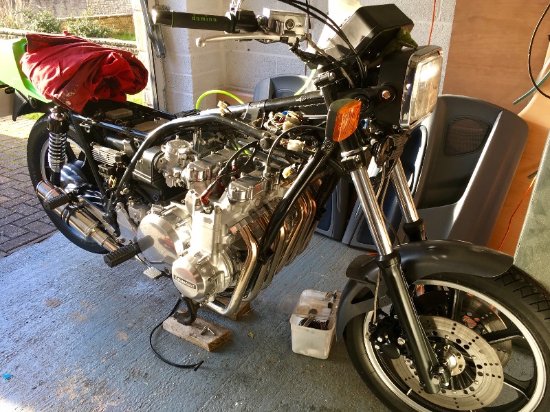

The current state of it. I have bought and modified a Predator 6 into 1 pipe and used a Black Widow end can. I fired it up the other day and it sounded way better than I thought it would. I leak tested the carbs again and squirted a couple of cc’s of petrol into each plug hole. It fired up first time. The radiator was left off to check the sealing of the exhaust, all was good.
