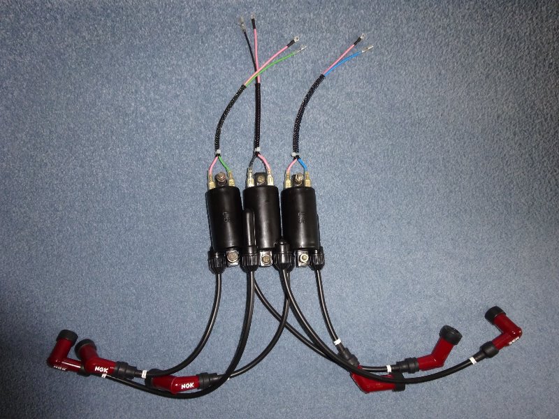

Created the ballast resistor. Its only zip tied for now until I decide to fab something up. The zip ties actually work really well. I couldnt find 90 degree spade connectors, but instead of cutting the factory wire harness. I used 4 lengths of wire, all three came back and ties into one. On the three wires, I put female blade connectors, and on the single lead, I put a male spade connector to plug into the factory harness without modification.
Problem 1:
I purchased a single coil, and a pair of coils. Wired them up, and got spark on one coil. Im beginning to be suspect that I should take the other 2 out, which were likely the pair and examine all the wire connections. I didnt test them other than the Pink/other color posts to calculate the resistor. I think maybe I should take them apart and examine them.
Problem 2: It seems the coils, although very similair, are not exact. When putting coil #2 on the top, the screw in part where the plug wire connects to the coil overhangs the hole for the shaft of coil #1 to come up through the bottom. Therefore neither #1 or #2 and firmly seat on the grounding areas. To over come this for testing, I ran a jumper from both mounting shafts of coil #1 , then spliced it and ran back to the negative battery terminal, and let it hang. No dice. I will take #1 and #2 out and check connections, and continuity tomorrow. Really had my hopes up on hearing this thing run. Plugs are new, carbs are cleaned, and the bowls are full. Should fire right up.

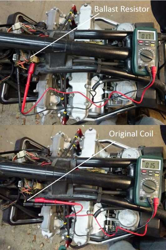

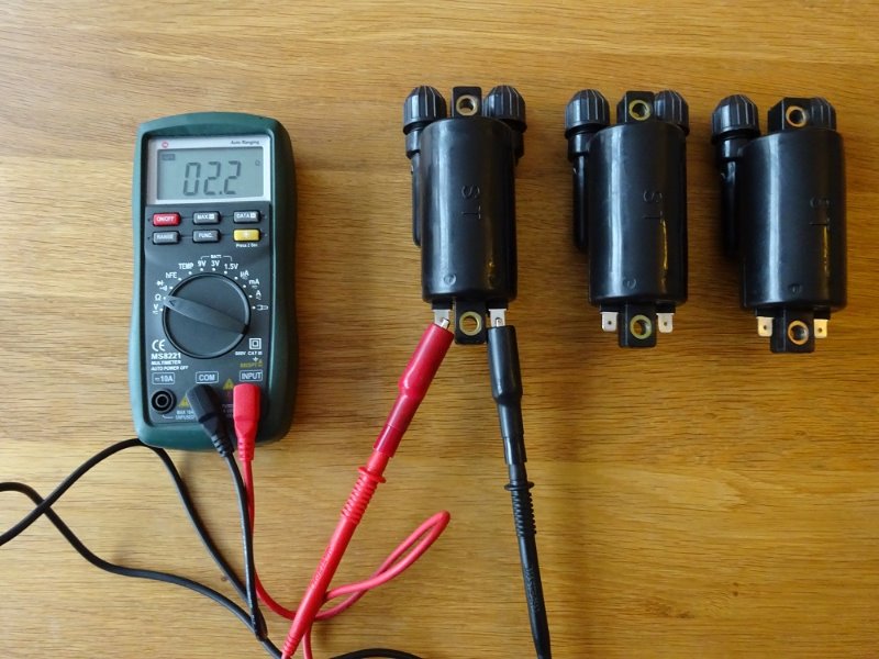

Regarding this controversial topic of resistance, I would suggest that there is an acceptable "range" of resistance where the ignition system will work well. The minimum seems to be about 2.6-2.7 ohm and no-one really seems to want to go above about 3.2 ohm. I personally would recommend that you use the same ballast resistance for each coil. I am not sure it is critical whether you go for 0.4 or 0.5 ohm resistors - I would probably chose on price or quality.
I measured my original ballast resistor and coils and they were both very close to the nominal spec quoted in the manual (see pic)
My new coils were measured using the same meter and came out a 2.2 ohms - all the same.
I wired them up using wires as close to the original colours as possible and all 20 amp rating. Just added some heat insulation to the lead wires as well.

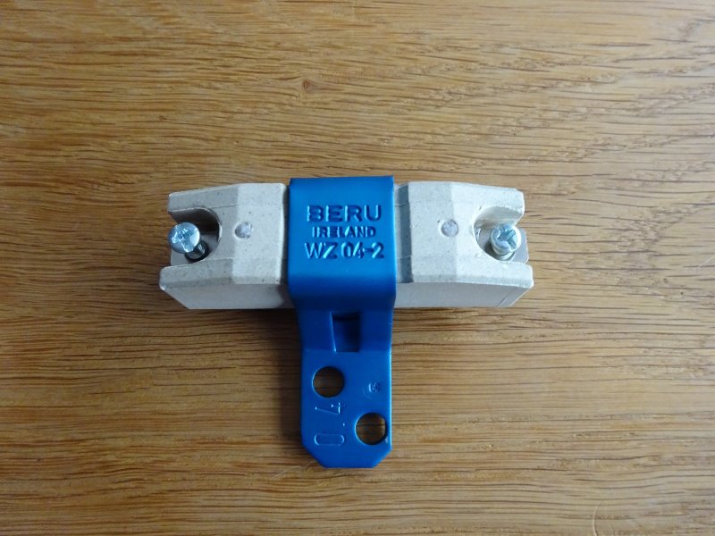

This were the original Beru resistors - important to remove the original mounting bracket carefully as the ceramic resistors are brittle
