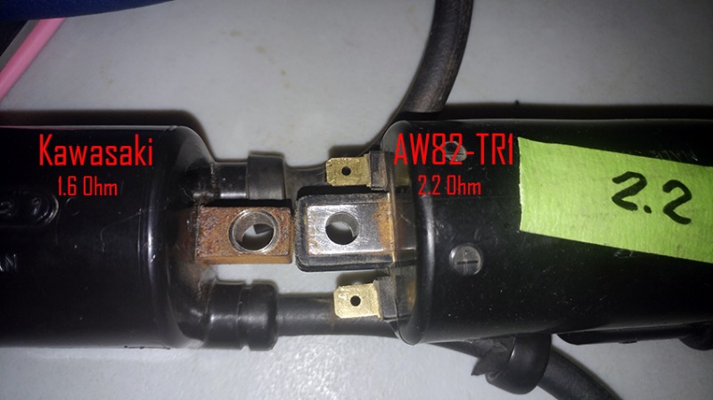

Great write up again Neville! As some expressed it, there's been a stir about the resistors and coils - I'd suggest it's been because some still have questions and there's been still not enough explained, not because they are ignorant or being an ass. So, thank you again for digging more into this AW82-TR1 coils!
From what I learnt, using these coils, I will go within the 2.7 - 3.6 Ohm range calculated from stock Kawasaki coils and resistors as safe. My stock resistors show 1.7, the AW82 coils I have show 2.2. So 1.7+2.2=3.9 is too high. Alternative resistors should be used and I think 0.5 to 0.8 are a safe bet, but based on happy stories of members using 0.4, I will just search for good middle road and good value 0.5 - 0.6 Beru or similar resistors, having all three the same value. One coils shows 2.3 Ohm and I think it's negligible.
The mounting holes - I might drill them out. I wonder why Kawasaki used those brass tubes instead of straight bolt on. Something with the heat? Vibration? Creating 'softer' barrier between the bolts and the coils to prevent stress and avoid cracking? I'll see how easy or hard drilling those holes is.

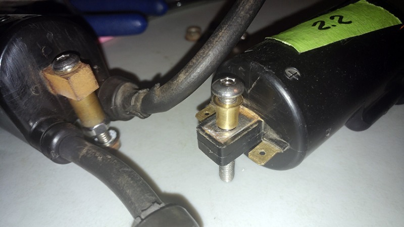

- StanG
- Banned
- Posts: 1987
- Thanks: 237
Re: New to me Neglected Kz1300B
7 years 10 months ago
Could be about magnetic field as well in the mix. Perhaps just simple protection of that core from the bolt's thread and damage it might inflict when servicing or vibration when riding. Perhaps a thermal barrier between them and the frame? Something interesting to research where this particular choice of material comes from.
As you see in the photo, I already replaced the original bolt with a stainless steel one, which is almost non magnetic comparing to regular steel.
The bushings go into the hole, then the bolt goes there. I didn't understand what Neville said about smaller diameter bolts - the original are not big enough to be used with AW82 coils on their own without being too loose - you'd rather need a larger diameter and skip the bushings which want fit unless those hole enlarged, and if that's done, then no need to change the bolt's diameter.
