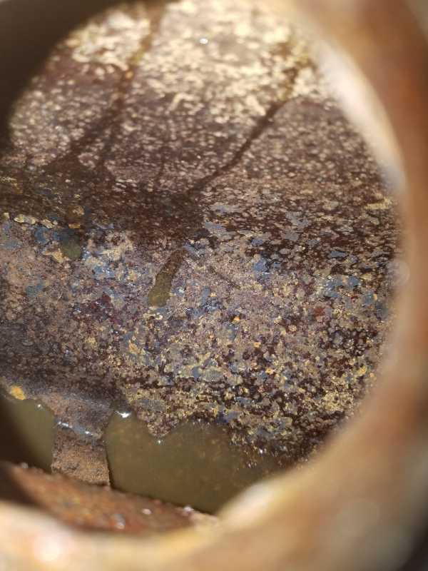

not to rain on any ones parade!, but looking at those pics ill reiterate previous thoughts
with that mileage looking as it does idd,
fill tank with coke leave few days , buy POR 15 kit, follow instructions(this seals up the whole surface of the tank)

Wow, nice find. You don't see much Vetter stuff around any more. I'm with Dion on the POR 15 kit. I have recently got my KZ1300 out of storage (sat for 22 years, still had 1996 license plates
). I used Vinegar instead of coke to clean out the tank. Then the POR kit did the trick . The carbs on mine were a mess, so I had them professionally redone. Found after much frustration that one of the pickup coils was bad, making it run on 4 of 6 cylinders. Now it's running good, just waiting for spring to get it back out and about.

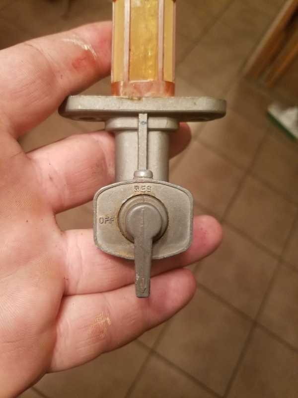

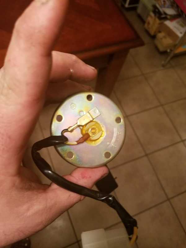

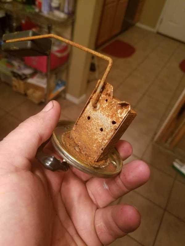

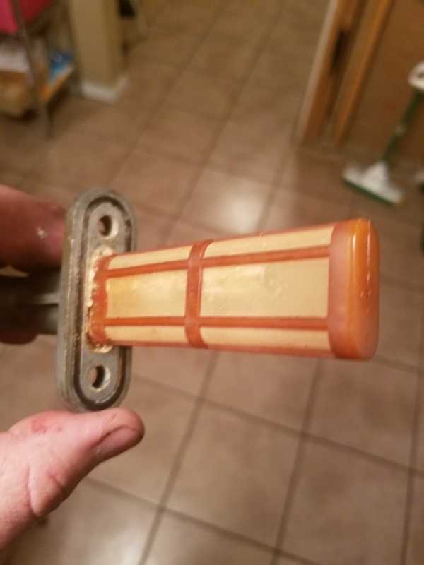

First round of cleaning out the tank went well with purple power to get the old gas varnish. I'll use apple cider vinegar when I get free time next. How does my petcock and fuel level look? I know the fuel level float needs a clean, but it actuated just dandy.
The petcock even has plier markings where the original owner forced it to turn. Easy way to fix that?

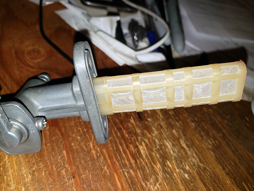

Just to chip in. I was lucky to get this from eBay for a low price. 20 bucks? Something kike this. I am running original petcock without any filter and having an inline fuel filter attached. This one was discolored, but I gave it an ultrasonic cleaning and it came out like new. Saving it for my next KZ1300. I'd still suggest an external filter.

7 years 5 months ago - 7 years 5 months agobluefan44 wrote: The petcock even has plier markings where the original owner forced it to turn. Easy way to fix that?
I know why that happened! Turning that tap 'by hand' can be a real bee-auch. When I picked up my bike the tap wouldn't budge. I dissembled and cleaned out the tap body which improved things but it wasn't long before the tap was inoperable again. The internal valve is a bit of a plastic 'cone' and the design puts to much pressure on that cone making it very difficult to move the tap. Based on some advice on this form, I filed down the tang on the inside of the tap handle slightly to relieve some of the pressure on the cone (the tang fits into a slot on the plastic cone). The tap is operable now but still difficult to use while riding (but not impossible) - mostly because of it's awkward placement.
