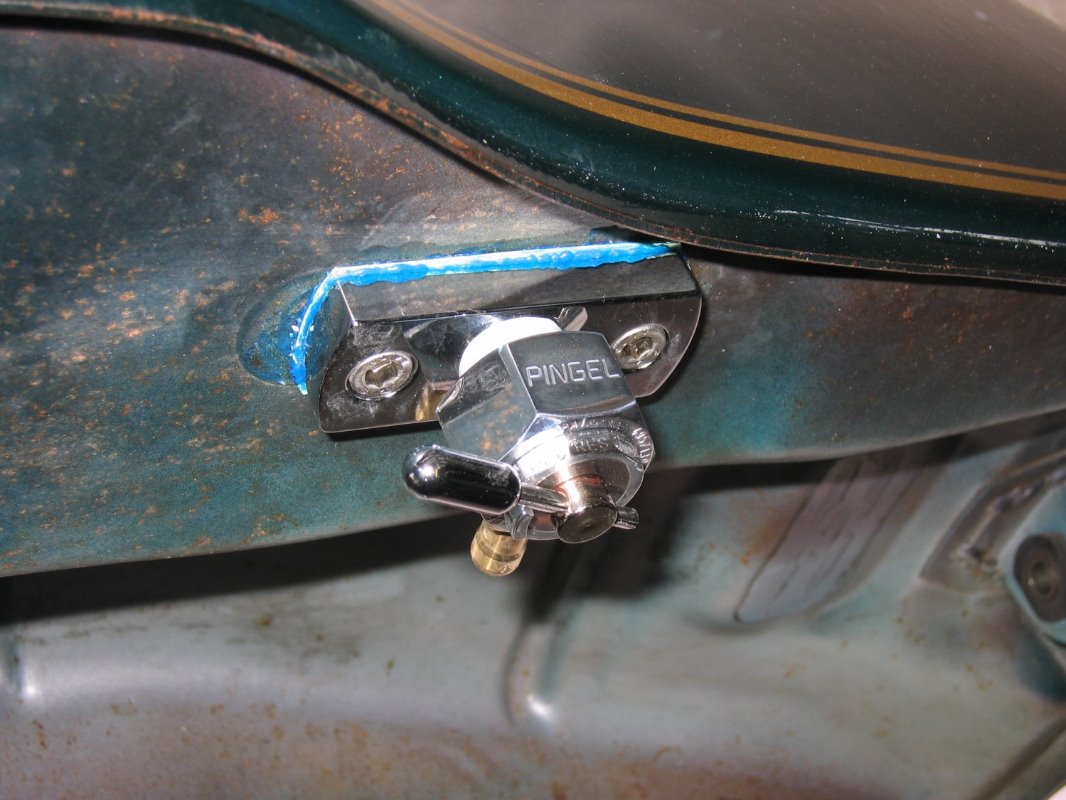

I have been through 2 standard petcocks - I think this was designed(?) by the same person that created the original cam chain tensioner - it was always going to seize at some point and both of mine ended up virtually unmoveable without mole grips or similar. My solution was to fit a Pingel valve in 2006 and have reaped the benefit ever since! - see picture. This is one of the best mods you can make to a standard bike and is described in the FAQ.

Before I buy the wrong thing again, this is the stuff? I also need liquid gasket any brand youd recommend? When i remove the solenoid what sort of issues will i encounter?

I bought the Pingel Valve from Z1 Enterprises - Petcock - Pingel High-Flow Fuel Valve - Single Outlet 3/8 NPT - part No. PI6211-AH. This mated to a Petcock Adapter Plate 44mm 3/8 NPT - Part No. PIA1702C. Your part numbers look correct to me. Also looks like the prices have increased somewhat from 2006! - I paid $67.94 for the valve and $12.40 for the adapter. I used Hylomar Universal Blue sealant as this is fuel resistant.
I have not encountered any issues in operation without the solenoid valve but religiously turn off the fuel tap when ever the engine is not running - over the years, many on this site have reported all sorts of issues with the solenoid valve. Suggest you remove it and put it in the same place as the original camchain tensioner. Hope this is helpful.

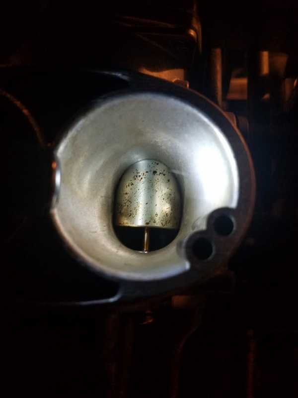

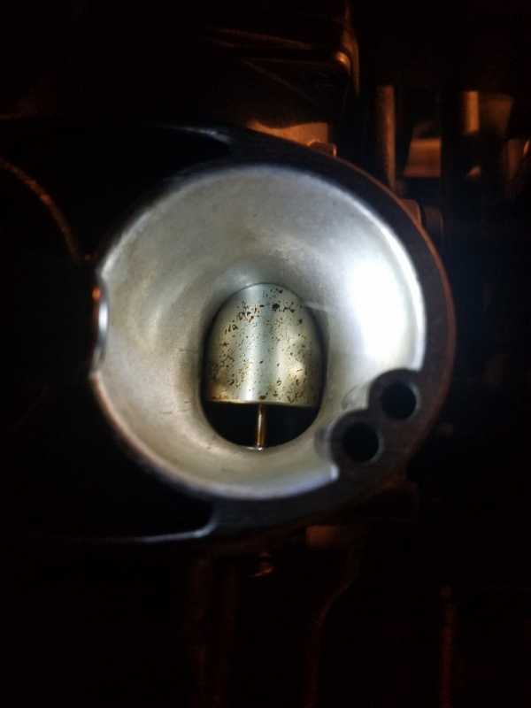

Looking good! Checked all the lights and everything is going except for the radio not working. Pulled the petcock apart and after getting everything lubed up it's still super bad so yeah I'll replace that eventually. Ordering 5 or so oil filters. The carbs are super clean. I'm going to throw some Marvel Mystery Oil on the Pistons let it soak for a few days and fire it up. Next week if I get it to turn over I'll go ahead and order new tires and take care of the brakes.
