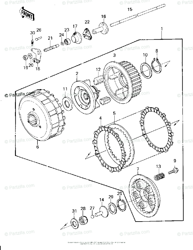

Stan makes a good point. If the push rod (item #15)came out then it is possible the ball bearing (item #27)fell out as well. It's 3/8" diameter and would account for your troubles here. Looking at the first video again, I don't see the actuator ramping in at all which tells me that possibly something is missing (likely the ball bearing only if the push rod fell out and you put the push rod back in not knowing about the ball bearing).

the push rod and steel ball assembly wasn't touched.
i have just now decided to crack open the holding bolt and undo this
assembly, only to make sure all 3 ball bearings are present.
the video shows all is ok, but then again im not sure as i dont know this bike and how it works....
