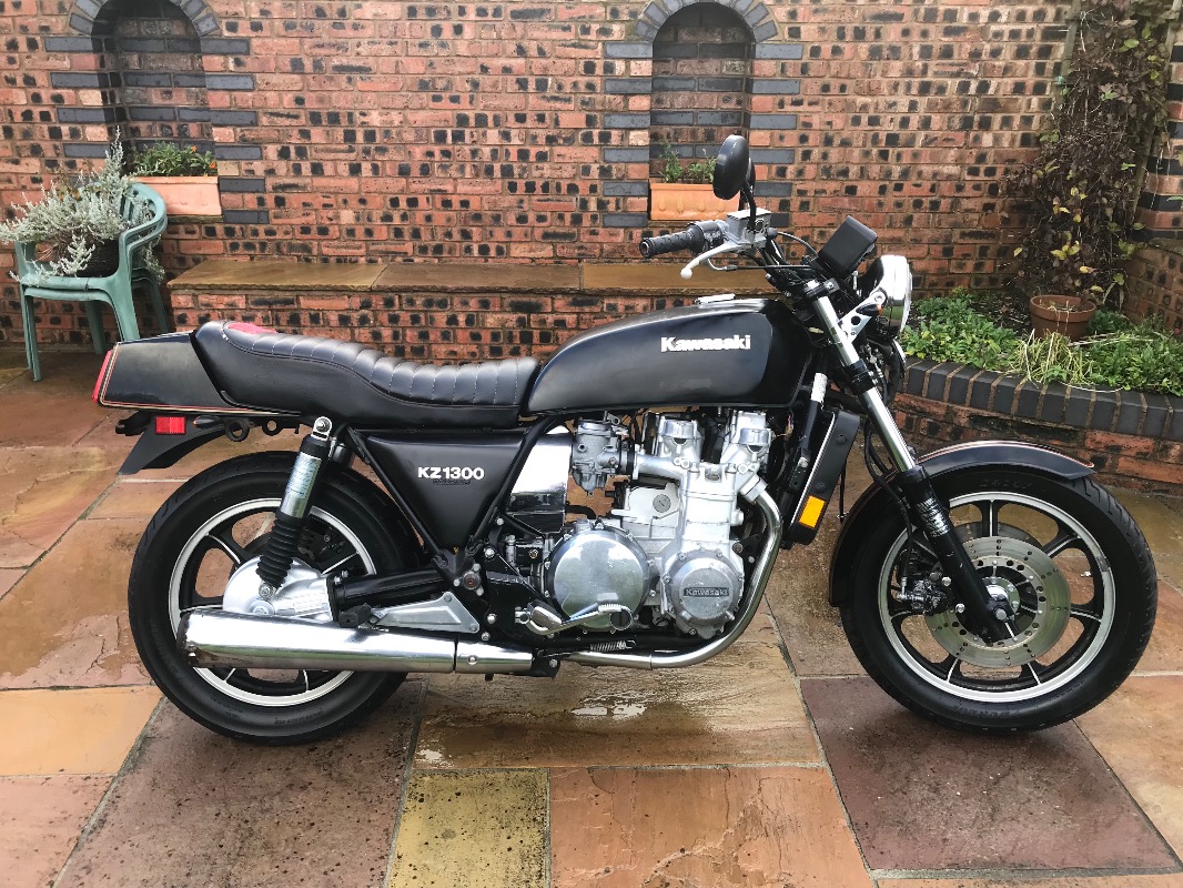

Hi All,
I am new to the site but have been rebuilding my Kz 1300.
Here are a few pictures from the beginning.

First, welcome to the group from one of the Canadians. Judging by your pics, you should fit in quite nicely. You've hit some of the high value target areas like the tensioner wheel I see.
First time seeing a pic of cylinder scoring. That's different.
Looking forward to seeing how you make out with this build.

Hi Kawboy i had to get it rebored could'nt see what caused the scoring and then use z 650 pistons .

Nothing stirs my heart like a freshly painted/powder coated frame.
