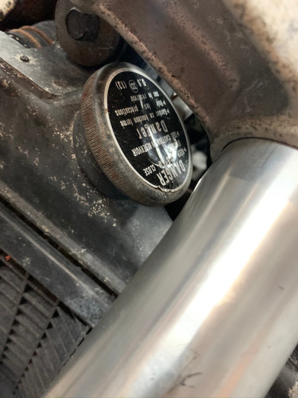

I Installed the front end from the CBR 954 today
it is lower the bike but I love the look, its not completely but looking good so far.
the lower yoke is probably thinner then yours so I clear the radiator cap with no issue.
Thank you guys for all the inputs

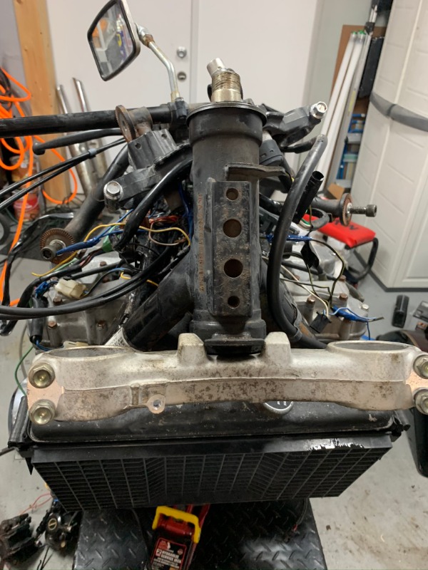

So the front end fit in with minimum mods
the lower bearing for the kawasaki and the CBR 954 is the same so that was easy
for the upper bearing I found one that will fit the Kaw out and the Honda in dimeter but it is 1mm lower then the original.

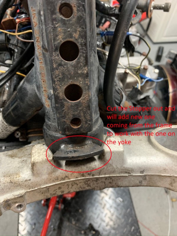

Here i cut the stopper from the bike, maybe the better solution was to cut the stoppers from the yoke and put new one in different location as Paul did.
didn't think about it before i cut.
maybe will weld smaller stopper back and relocate the one on the yoke or I will add adjustable stoppers from the frame

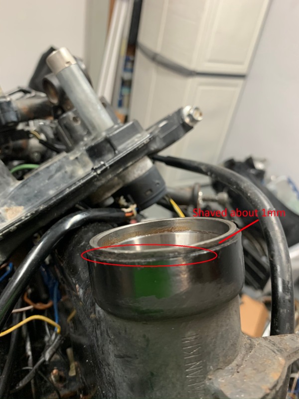

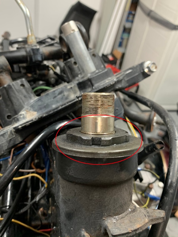

now the issue I found was the rod is a bit too short, 3mm more and I'm fine
I do not have enough space / threads on top for the second locking nut
since the upper bearing will be 1mm lower I shaved 1 mm from the top, im waiting to get the new bearing too see if i can shave more
