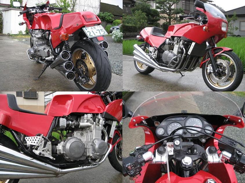

This bike was done quite a number of years ago, and it was a big project.. Probably not what you are looking to do -ideas maybe.

I specifically looked for a front end that had the same dimensions as I did not want to lower the bike. It is already difficult to turn/lean and the advice on the forum is not to mess with the ride height. I also wanted a USD set of forks. Only one I could find that conformed to those requirements was from a Benelli Tre K and that one is 2 cm longer, so I have something to play with. But I decided to keep the KZ steering pin, so had to find a way to insert that pin into the Benelli bottom yoke. Then I decided to make my life easier by also adopting the front wheel and brake set up from that bike, so that all first nicely. But obviously I now have to solve the radiator issue.
Tackelhappy; awesome exhaust! Where from did you get that? I'm still deciding on what to do with mine and this has now become a contender!

I fitted a ZZR1100 (you guys over there call it the ZX-11) front end to mine, it looks like whoever built that red one wit the 6 megaphones did the same as I recognise the clocks too . On the subject of fork length they were a good 4 inches shorter than the originals so I had some sleeves machined up in steel to lengthen them. And on the subject of the bottom yoke fouling the radiator cap McBoney I had to have a small section machined out of my machined from ally billet bottom yoke becasue of the same. Although that's just got me thinking because it was machined to clear the original cap, which aren't available anymore & I've just bought an alternative one which is a different shape to the original & have yet to try it. Bugger :pinch: Rear wheel widening I got mine done by a fella in Germany about 20 years ago, it takes a 180 section tyre. Modifications to the swing arm were needed too, but they weren't that extreme. I know Kosman over there in the States provide a motorcycle wheel widening service but a friend who lives there had some done for his KZ1300 & he wasn't very pleased with the quality.
