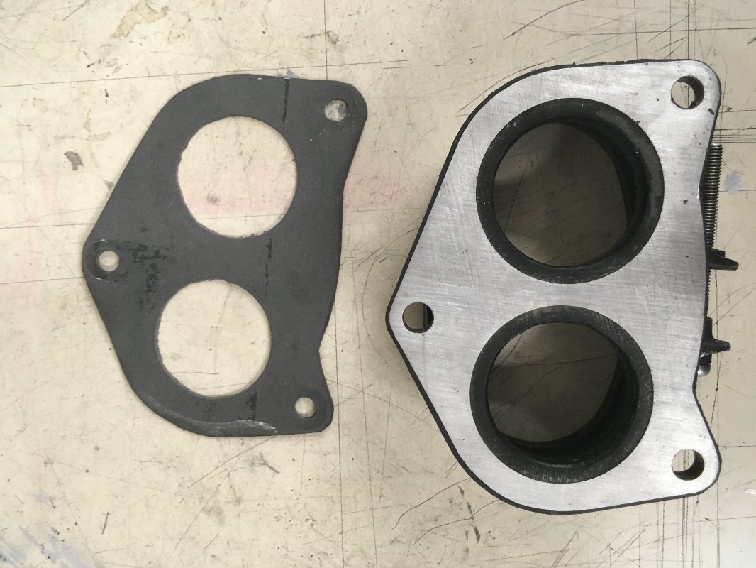

First thing that comes to mind is a vacuum leak.  Whether carb'd or F/I , a gasket between the holders and the manifold will eliminates the vacuum leaks there.
Sand the holder surface as shown and add the gasket (dry)
