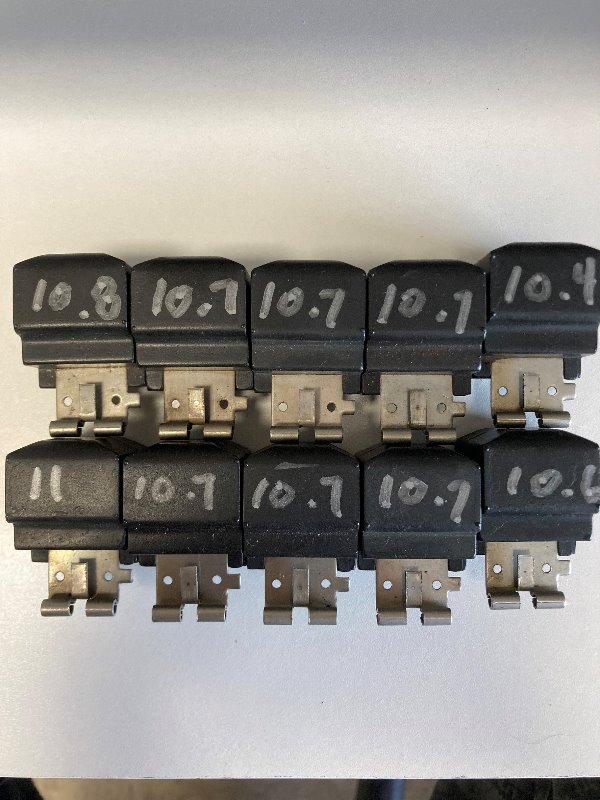

A) Open tank gas cap or gas can, be sure it's fully vented and NOT pressurizing the system
Weigh the floats.. I have an OEM set somewhere, perhaps Scotch can tell you what his brass floats weigh. Too heavy = minimum shutoff capacity.

3 years 9 months ago
Always High - Know Fear !
