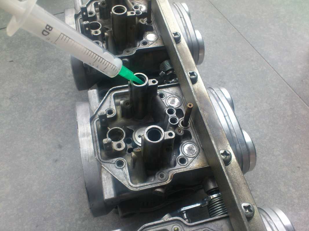

well, didn't do much for some time, but at it again now.
middle carb channels from main to pilot jets where both clogged, witch I guess was the problem the 2 middle cylinders where not idling but running when riding.
after flushing, see pictures, while using cloth in the carbs not hurting the shaft seals, it poors out the pilot/idle screw hole like the other 4.
Can I now be pretty sure the idle circuit is clean? I didn't find any others channels to be clogged.

The problem you describe is a transition port issue. In the top of the throttle bore at the throttle plate are 3 tiny ports which feed fuel progressively as you transition from idle to the main circuit. If 2 of the 3 ports are clogged, it will idle ok but not run properly until it gets up around 1800-2000 rpm. The only way to check clear these ports is by blowing compressed air through the 3 ports with the idle air screws out to reverse flow the air and any debris back out to where the idle air jets are. I took my air gun for the compressed air hose and made up a copper tube with a 90 deg. bend in it to be able to blow these 3 ports out. Works great. Then you can take your brake cleaner and fill up the circuit at the idle air screw port and blow it through the circuit with the compressed air and watch at the 3 transition ports.
