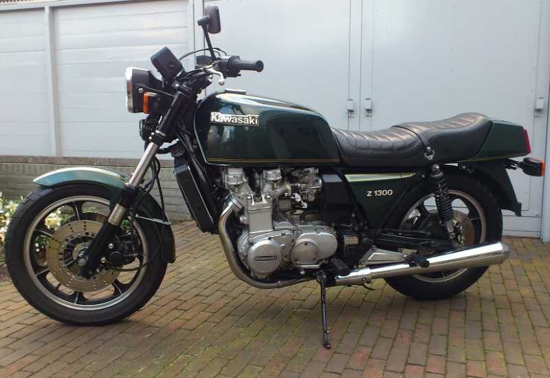

I'm going to have my first z1300 redgistered, which I bought 2 months ago.
It has not run for a couple of years, but at the moment it fires up in an instant, after I put in new spark plugs..
it picks up from about 1900-2000 rpm, below that it's struggling a little..
It iddles without any problem, but I think it is not running on all six all the time,
pipe 3 en 4 are not getting hot quick, maybe carbs still need cleening, or just wet spark plugs maybe? The guy I got it from said he cleaned the carbs, but he said it might not be 100% yet..
I only rode it for a couple of miles, and in 2 days I will drive it to the registration office.
I'm not planning to take the carbs apart any time soon, because I have another project that I want to finish first.
My question for now is: If I can ride it without any problem, maybe not running on all six, should I worry about it? Or just ride it and see if it gets better, while doing some adjusting and testing?
If it's wet spark plugs, should those cilinders pick up if the engine gets warmed up?

By the way, nice looking original KZ.
T.

groetjes to Nederland, nice looking bike (I'd better stay with english rather than write somehting completely stupid in nederlands).

btw, paint is not original.. unfortunately..
