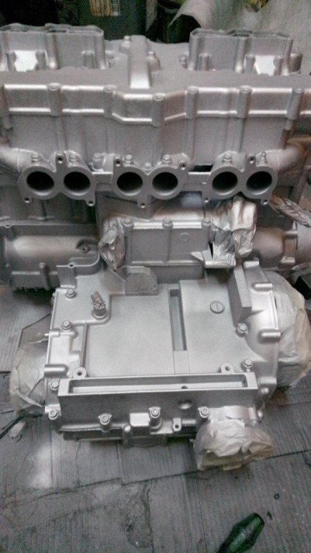

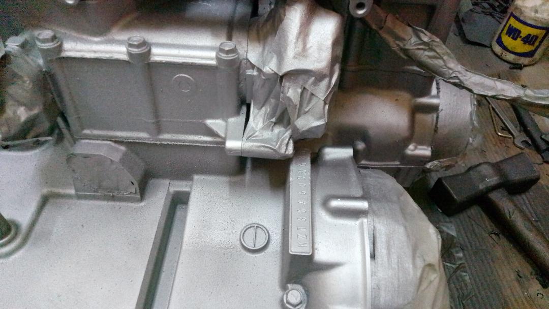

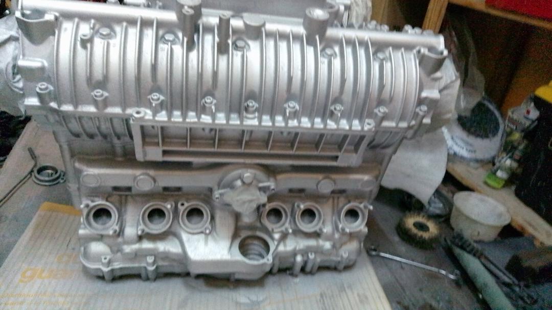

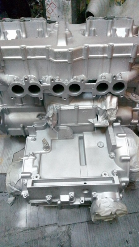

The painted engine already looks better.
If I can't start the motorcycle, I will place it as an ornament in the living room of my house, between the grand piano and the fireplace.
