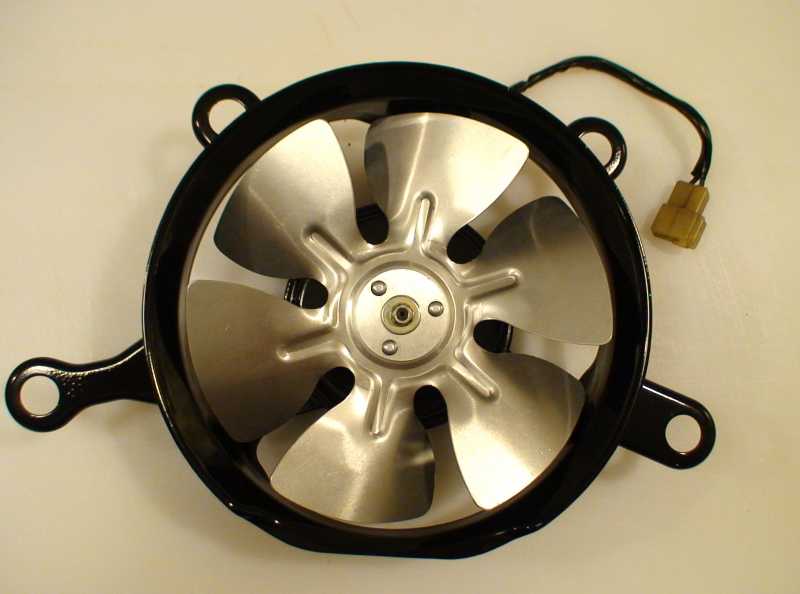

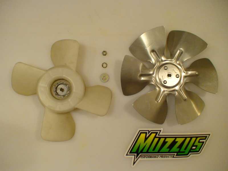

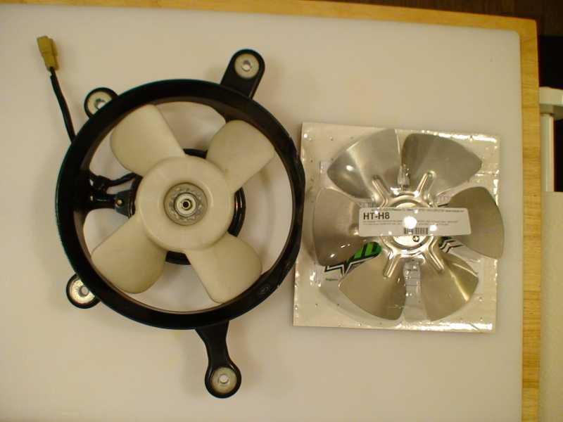

4 Blade stock fan and the new 6 blade Muzzy fan

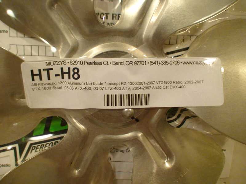

Notice: This particular fan (Model HT-H8) is still available through Muzzy for $39.95 and is designed to fit every 1300 model EXCEPT the KZ.
With a few modifications, this becomes an easy install for the KZ.
Muzzys Inc. • 62910 Peerless Ct. • Bend, OR 97701 / ph 541-385-0706 fax 541-382-9406

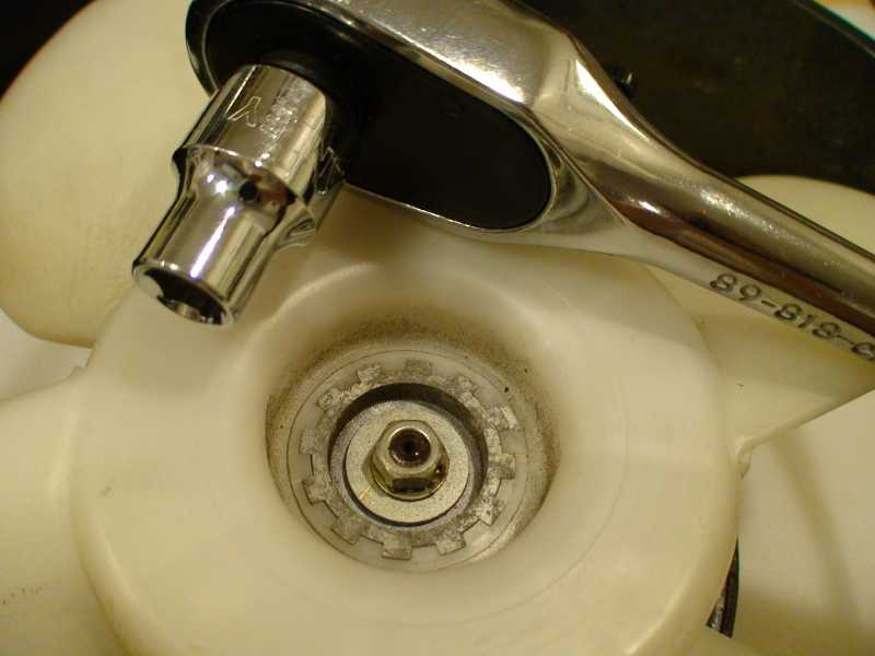

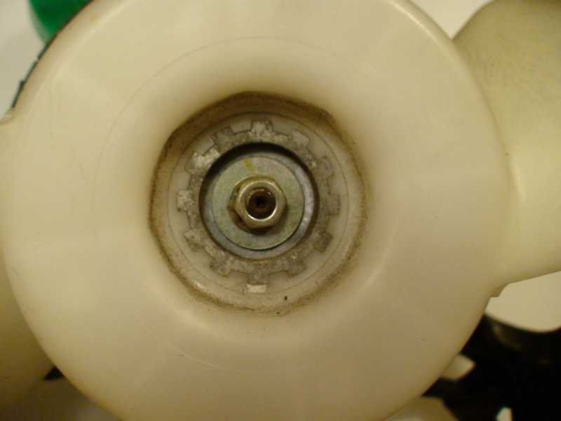

After removing the 8mm nut and two washers, you'll need to remove the center aluminum hub from the stock fan blade. Don't worry about salvaging the old fan....you're done with it.
Notice you not only pick up two additional blades, but they appear to be at least 25% to 30% larger than the stock blades.
Using an arbor press, remove the center hub from the stock fan. If a press is not available, using an appropriately sized drift or socket, (with a hammer), drive the hub from the fan. Don't worry about salvaging the stock fan...... you're done with it.

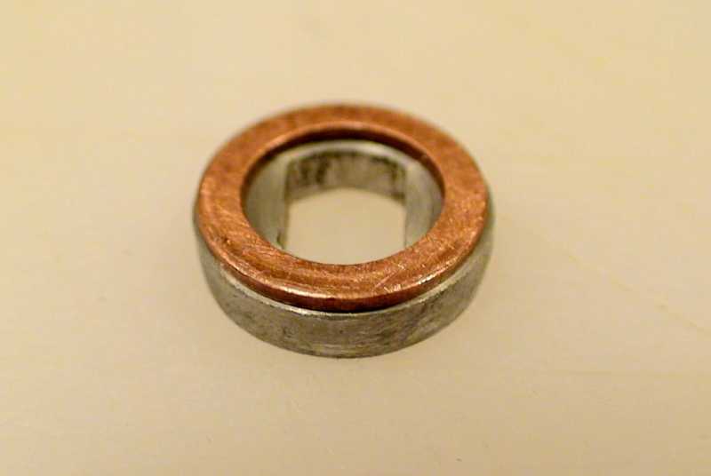

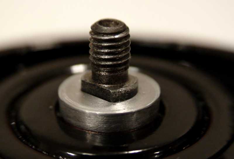

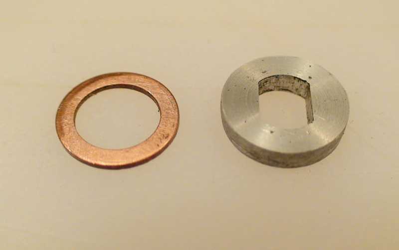

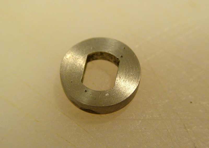

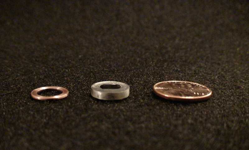

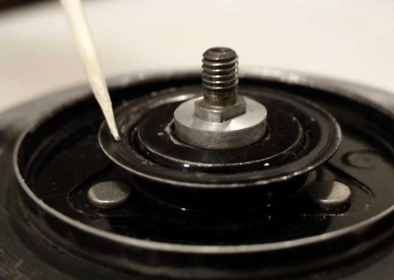

After pressing the center hub from the stock fan blade, acquire the services of a competent machinist. (On a lathe), turn the large end of the hub down until it is JUST removed, leaving nothing but the small end of the hub. In the pic below, the remaining hub is .105 (one hundred and five thousandths) thick. It should be no less than .100 thick and no more than .110 thick. These were the instructions I left with my machinist, who MAY have removed slightly more stock from the small end of the hub. Once you have machined the large end completely off, using a micrometer, measure the remaining small end. IF you have a thickness of .125 or more, there is a strong likelihood you may not need to add the copper washer described below.
After machining the hub (so only the small end remains), I installed a copper washer UNDER the hub,
to give it enough height so the rivets in the new fan did not make contact with the inner flange of the fan motor.
Sorry.... no dimensions on the copper washer. It was in a box of old washers I had lying around. It was NOT an exact fit for the fan motor shaft, BUT it was perfect in thickness, to give me the necessary fan clearance, and its diameter was identical to that of the machined hub.

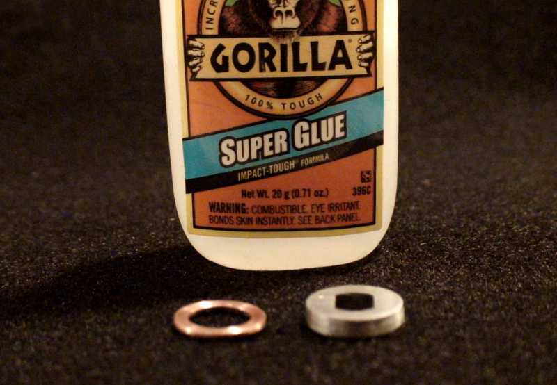

A TOUCH of Super Glue perfectly marries the copper washer to the machined hub. Apply a MINUTE drop of Super Glue at 12, 3, 6, and 9 o'clock on the bottom of the machined hub, then align, press and hold the two together for approximately 60 seconds.

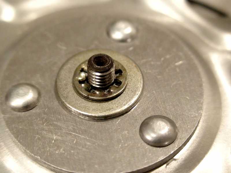

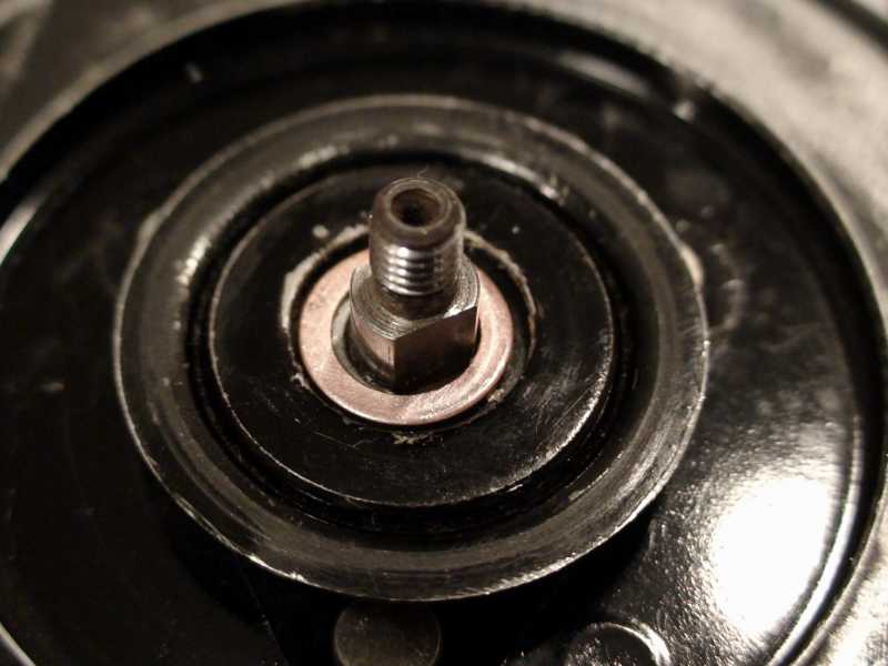

Remove the three 5mm screws and washers that secure the fan motor to the motor shroud.

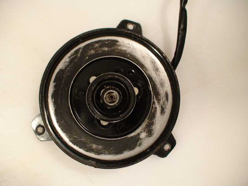

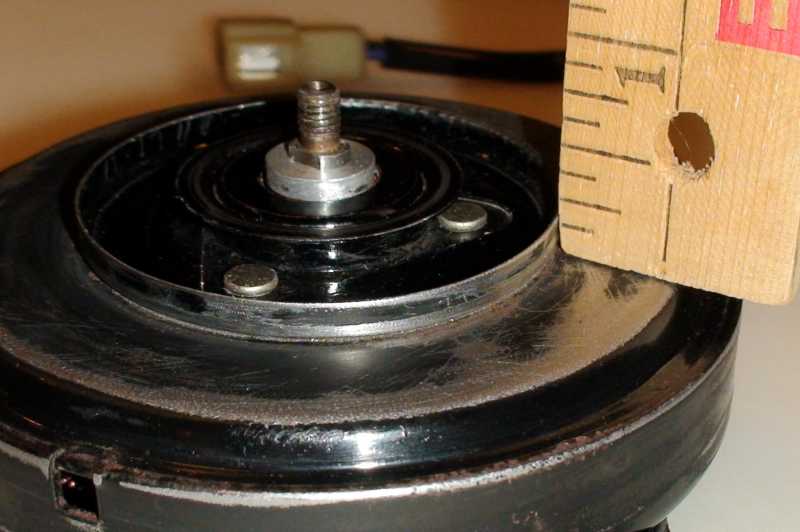

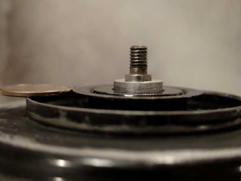

Chuck the fan motor in a lathe and turn the outer motor flange to a height of approximately 3/16". Turning it any shorter serves no purpose, as this is all that is necessary to give adequate clearance between the outer motor flange and the new fan.
After machining, the height difference between the inner and outer motor flange is about the thickness of a penny.
You're all done with the machine work. (Total cost for machining the hub and outer motor flange was $20 and about 15 minutes). You could hacksaw, grind, or file down the parts (and it will look like you did), but it's hardly worth the hassle for 20 bucks.....and you've only got ONE center hub.
I elected to paint the motor and shroud with VHT high heat gloss black paint ($9 at O'Reilly Auto Parts)... (good to 550 degrees)... but ONLY if you cure the paint. I scuffed it all up with a red scotch bright pad and dusted on two coats about 10 minutes apart, then sprayed on a medium wet coat. After 36 hours, I hung it in the middle of a 200 degree oven and "cooked" it for 1 hour. No, it didn't melt the fan wires or plastic plug in. After letting it cool completely, I reassembled it.

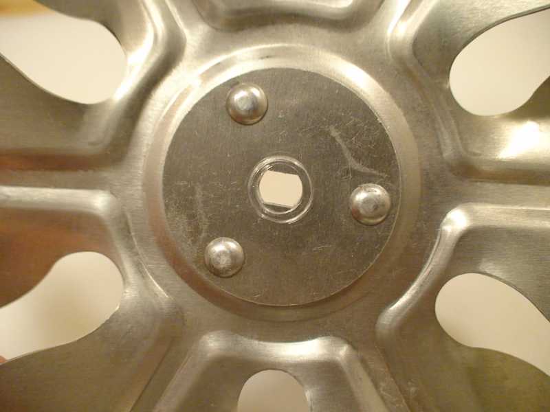

Riveted washer on Muzzy fan faces UP
There is a "rounded" side and a "flat" side to the flat washer. Make sure the "flat" side is down, against the riveted washer on the new fan.
Before reinstalling it on your bike, test that the fan spins freely with no interference or drag of any kind. Connect jumper wires from a 12 volt battery charger (negative lead to the black wire and positive lead to the blue wire). You should feel a noticeable increase in the fan volume. If it works without issues, you're good to go.
