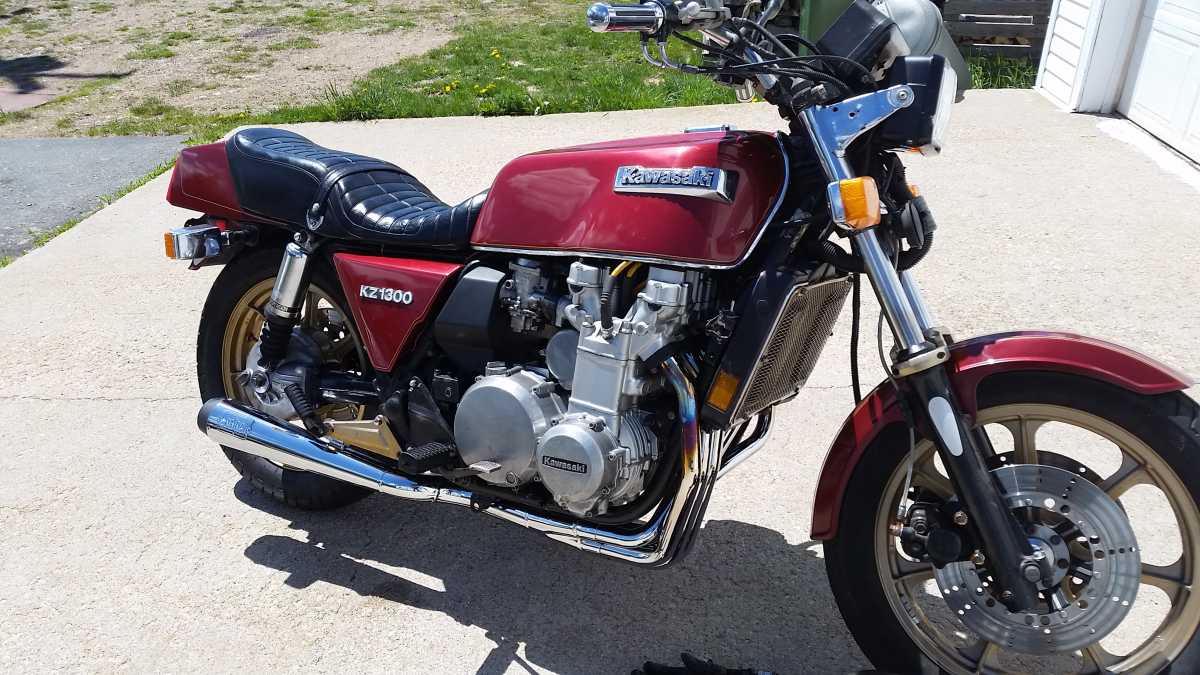

It worked this time.
As you can see, my outside pipes are turning blue and gold. The 4 middle ones aren't bad at all. Sucks to be me.
Starting turning blue minutes after I started it. Obviously the mixtures are screwed up. Tomorrow I'll pull all the plugs and see what is going one with them.

The blueing could be a couple things. If the exhaust is stainless it will do that anyway. If not, those two cylinders are running overly lean and burning too hot.
It may be worth getting an IR temperature gauge. You can kind of judge mixtures by header temps (hotter is lean, cooler is rich) and get a sense of where your mixtures are at, and what cylinders are firing.
As for the carb boots, I wouldn't worry too much about them if they are "upstream" of the carbs. All that's happening is a bit of unfiltered air is getting mixed in with the filtered. The carbs will sort out what they need. It's the air leaks "downstream" that you really have to worry about.

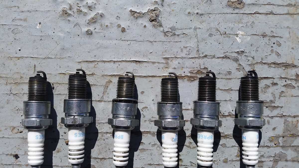

I pulled the plugs today. Number 1 cylinder was wet and black. The rest are dry with whitish ash. Hopefully this picture posts as sometime it won't work for me.
