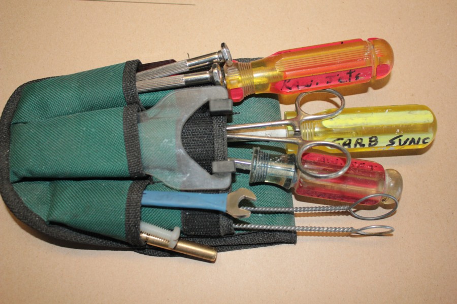

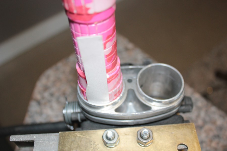

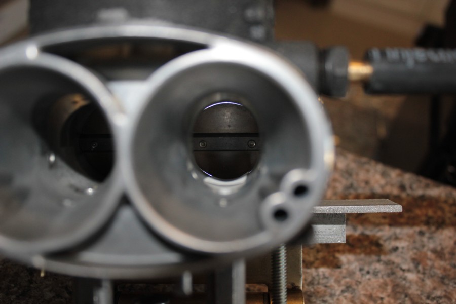

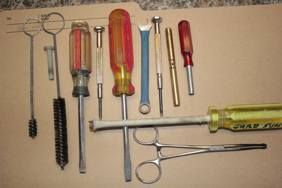

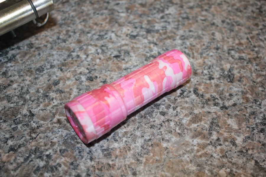

Despite there being a spring between the Ball-joint pins (in the center of the link-arms) I discovered recently that it's easy to tighten the screw down too much during the static set-up. Ended up having the same issue with the throttle not wanting to return quickly, if at all. Backed the screws off a bit, re-scyn'd and all was good.
You don't need to be an "expert" to over-haul the carbs. Just a good sense of organisation, patience, a note-pad for reference notes and a phone-camera for some reference photo's. AND Some very easy to make specialized tools referred to in a number of carb-related articles in this forum. The photo's are self explanatory but will add that having an inventory of the "special" tools always at hand is the biggest asset you can have for carb.-work. I find that statically setting the carbs with a strip of paper and a flash-light works well for me.
It all comes down to familiarity. "Until you understand, You'll never Know. Until you know, you'll never understand !
Note how I never made a gratuitous reference to either "the Brass Floats" or "the Cleaning Tool" !
