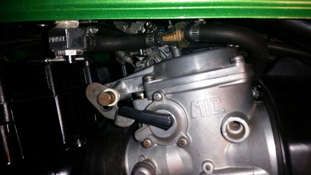

After owning and working on 1300's since 1979, I have yet to find any other fuel tap that is a direct fit onto the 1300.
There are some that "nearly" fit but have outlets in the wrong direction or are too small.
The only repalcement tap I have heard of that does actually fit is the Pingle, and you do need an adapter plate to fit it.
Numerous suppliers and EBAY sellers claim to have taps that fit..........but I can tell you their information is wrong and the dont fit.
This is one of the reasons whay I fit electric fuel pumps to my own 1300's as it means you dont need to turn the tap on or off as the pump stops the flow one the ignition is off.

The pingel will fit with the adapter plate but you will have to modify the hole as it is ovoid and needs to be rounded out in the center. I emptied my tank, flipped it, filled it with water and used a stepper bit to enlarge the hole.
Make sure you clear all the gas and fill it with water so you don't make sparks that go boom with fumes.

I don't recall having to do anything, the adaptor was a direct bolt on and the Pingel screwed right in....
I would highly recommend you go that route Dave, much better than the OEM one.

Now I think of it Led, my 81 has a different tank style, so that must be the difference.
Even if you have to modify the tank, then by all means do it. I would go so far as to pull that ridiculous shut-off solenoid out and toss it in the trash can.

Yes, the 81 does have a different style tank. I have an 81 tank but I've never taken the petcock off of it. It does leak a bit through but the 81 is parts bike so I don't care.
The 79 tank was a bit of surprise when I found the oval hole which didn't fit the round pingel tap. The instructions said use a file to widen the hole.... would have taken me days since its a double layer at the tap. I didn't want to blow up so filling it with water seemed the safest route. I'm still here so.... :woohoo:
