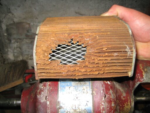

I remember a pic on this site of a carb inlet side with half of a fly larvae cocoon stuck in one of the 6 ports you mention. Truly amazing what animals or bugs will use for housing accommodations. I also recall another member showing a pic of mouse bedding inside of an airbox. Just go to show things we need to check on our bikes before firing them up after a long storage period. But this one that Scotch brings up is definitely something to be considered. Who would have thought you needed to check these ports.
