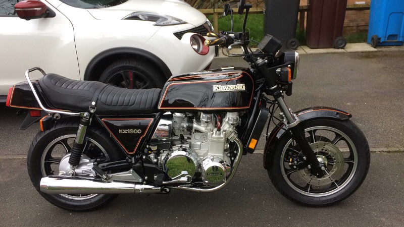

Hi Tim,
After finishing off the bike at the weekend the final job was to balance carbs and the usual tweaks. Well, the carbs refused to balance with all kinds of popping and back firing and the middle carburettor refusing to stop overflowing fuel into the air box. The carbs were on and off 3 or 4 times on Saturday with me finally noticing that the left carburettor throttle slide was sticking and not returning to the bottom position.
Cleaned throttle slides and bores, reassembled and bench set carbs by using Scotch’s paper strip method. Started bike up and couldn’t believe how close they are. Only the left carb was about 3 hg different to the other two carbs. Adjusted the left carb and the bike was very responsive and seemed to run perfectly. Tightened everything up and restarted bike. Ran ok for a few minutes and then a misfire occurred. Noticed cylinder number 5 was not running as hot as the other cylinders. Checked the plugs and it’s oviously running rich. Cleaned plugs and restarted and once again gran perfectly. Think I’ll order a colortune to carry out the final adjustments.
A friend called round today to have a look at the bike and obviously wanted to hear it running. It refused to start, choke on or off, it didn’t even cough. Will try to have another look later on this week as have it booked in for an MOT on Saturday.
