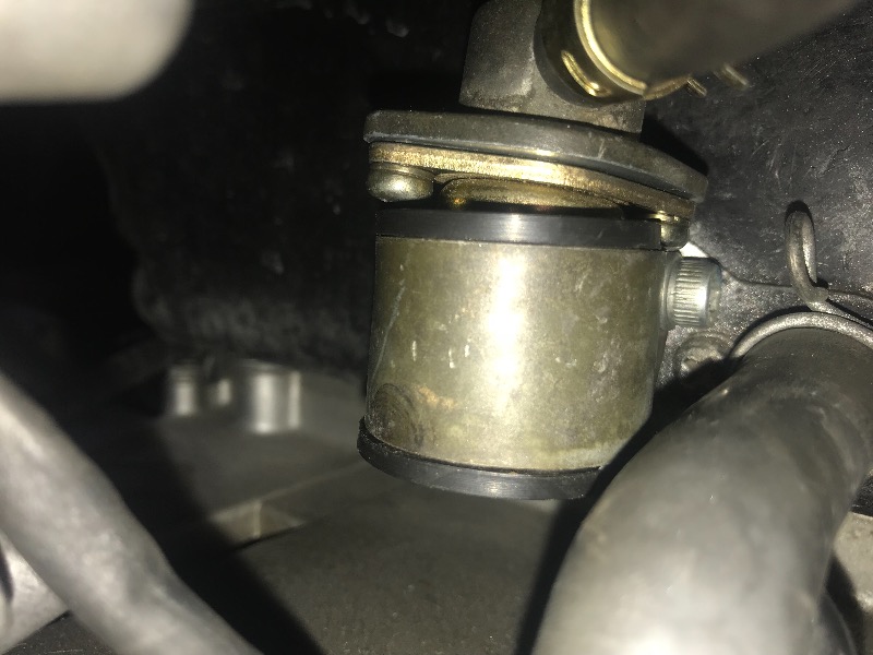

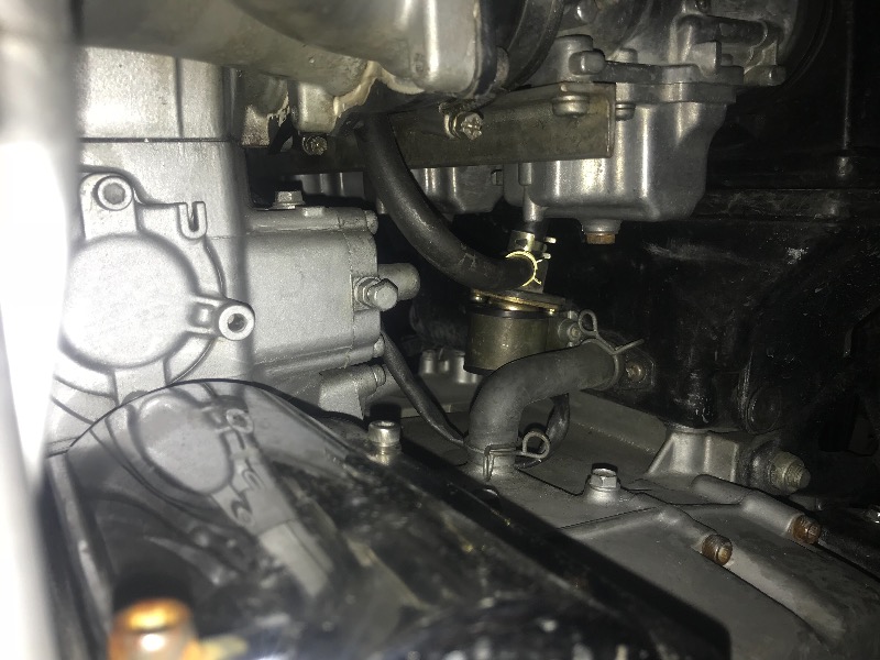

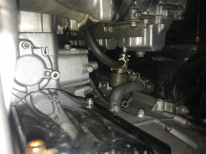

It just occurred to me that you may be mistaking the OEM fuel solenoid (electric shut-off) for a pump. A photo would clarify this !
If you have the correct fuel-level in the bowls then you have blockages in the idle circuits and the carbs (after-sitting for so long) need to be completely disassembled and flushed thoroughly. Don't be surprised at what comes out of them!

It’s a small canister under the carbies that fuel pumps out when the ignition key is turned on. Has a rubber fuel hose going into the carby feed line, so I assume the fuel is getting into the carbies. I’ll try an upload a couple pics
