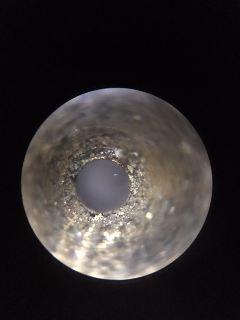

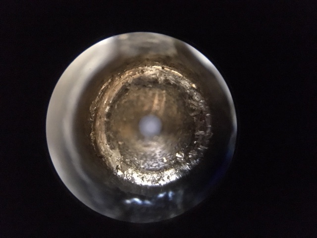

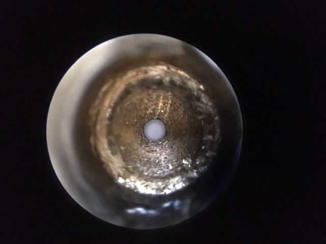

Curiosity got the best of me so I found the idle-jet that was stuck in the carb body that was donated several years ago for my "experimentation", (Thanks ! You know who you Are)
This idle jet shows the same pitting and galling as the six that are currently waiting to be replaced. I'm convinced this destruction to the fine finish and tolerances is from Cavitation Erosion and is a condition that we can not control or eliminate ..............................yet !:evil:
Three depths of field - same jet

That adds to complete the picture. Now, the topic can be renamed to 'How your idle jets get naturally F&%#-up' :woohoo:
