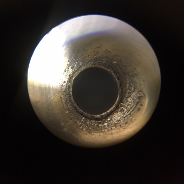

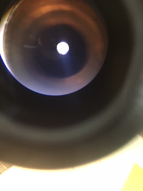

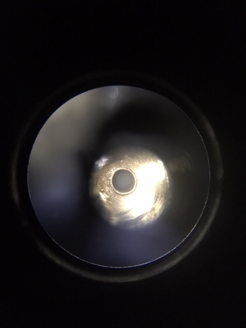

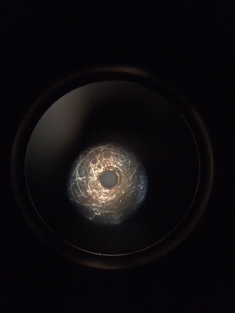

Despite visually inspecting the idle jets and determining they were clean I removed them and put each one under a microscope.
Long story short; If you want to render these jets totally useless go ahead and poke some piece of wire through it. Those “Jet Cleaners” ……..nothing more than Oxy/Acy tip cleaners – just as bad.
If you have to clean debris from a jet and lacquer thinner and compressed air won’t do the job buy some propane/natural gas pilot jet reamers and do it right. Or….just replace them with new jets.
The orifice is factory milled and reamed to guarantee a very specific flow pattern and should be shiny smooth.

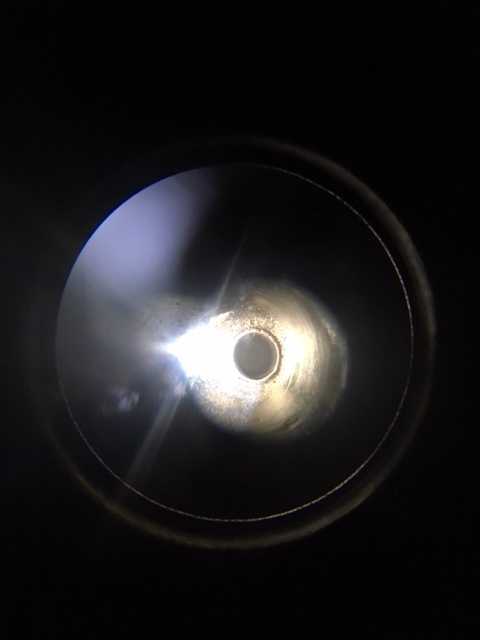

Sticking a piece of wire into it and twisting:
The end of a piece of wire will gouge and lift material that with totally screw-up the flow pattern.
You have to look closely but the jet material has been shaved and lifted.

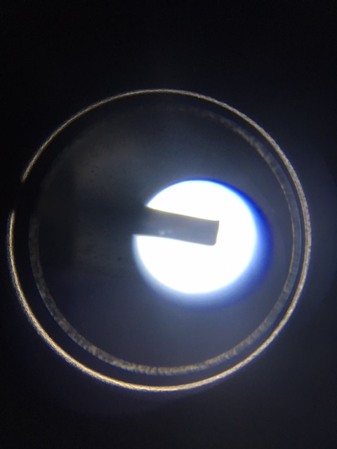

This is the end of one of those "Jet Cleaners" Same results as a random piece of wire cut with typical wire cutters
The end-burr will destroy the jets characteristics.

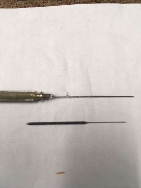

A couple of very fine Gas appliance pilot-jet reamers.
The solution: 6 new jets !
I've rebuilt 12 set in the past 3 years with no problems setting them up. Lucky, now I think. What have I learned: Holding an idle jet up to a light source doesn't guarantee the jet is good. From now on, every jet goes under the scope !

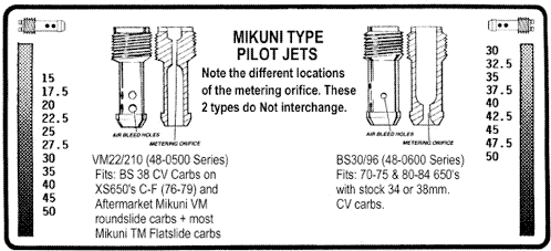

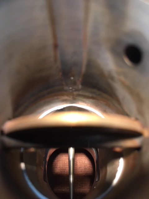

Your findings are disturbing. I would be interested in hearing how things work out after a new set of jets. I have seen jets with an overbore through 80% of the jet and only the last .025'-.030" of the bore actually "sized" to the jet size. Punching out jets with number drills was a common practice back in the old days and Mikuni frowned upon it. The only time that practice worked so to speak was when someone was changing to alcohol for fuel.

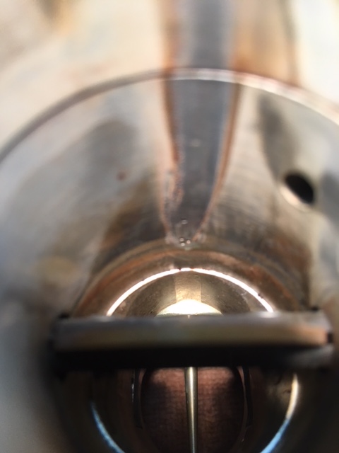

Just throwing this pic in here as an example. The entrance and exit angles of the jets are just as critical as the size of the jet. Change those angles and turbulance will cause the jets to not flow properly.

I can't find anything more technical or detailed regarding the entrainment of air into a flow of idle fuel .
Noun: entrainment
entrainment (plural entrainments) - Any of several processes in which a solid or liquid is put into motion by a fluid.
This process is obviously critical to the correct concentration, size and dispersal of entrained air (bubbles) in the idle fuel..
With air (bubbles) now of uneven size and distribution the flow of fuel is impeded. Hence the Lean condition which could be temporally corrected by blocking the mixing-air ports. Fair to say in this case it's not a "Blockage".
A "Tip Cleaner" is not intended to be forced through an opening. A size that allows the cleaner to pass easily, allowing the spiral cutting edge to "Rub" away foreign material, is the idea.

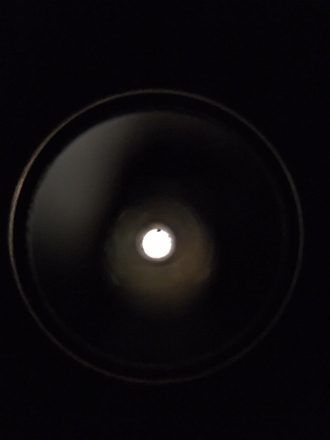

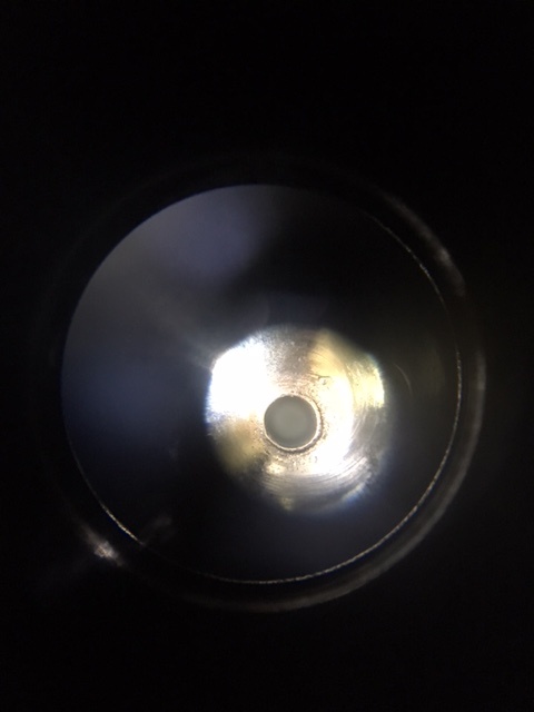

A good spray pattern

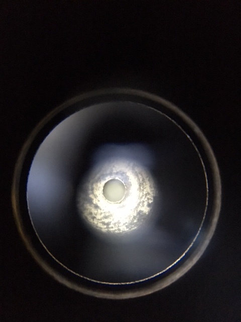

A spray pattern being affected by a disrupted flow

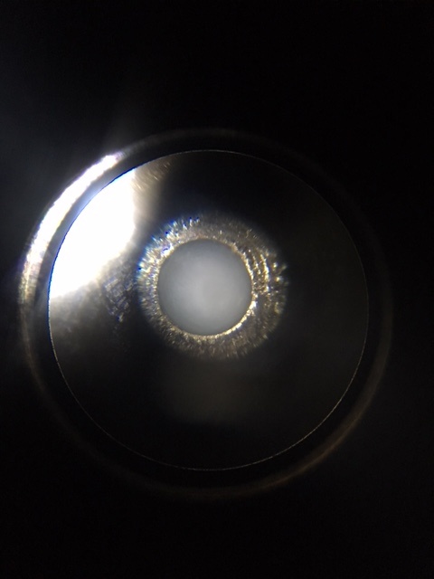

Better pictures of how little it takes to make getting a decent idle, impossible.
Same jet refocused (very narrow depth of field) to another area

With some better lighting I discovered these jets had more problems then just being "burred" in the orifice. Some serious erosion/corrosion that likely had as much of a detrimental affect. All contributing to flow degradation. This damage was hidden by the fuel residue and natural Patina. Damage was identical on the inlet and outlet sides.
