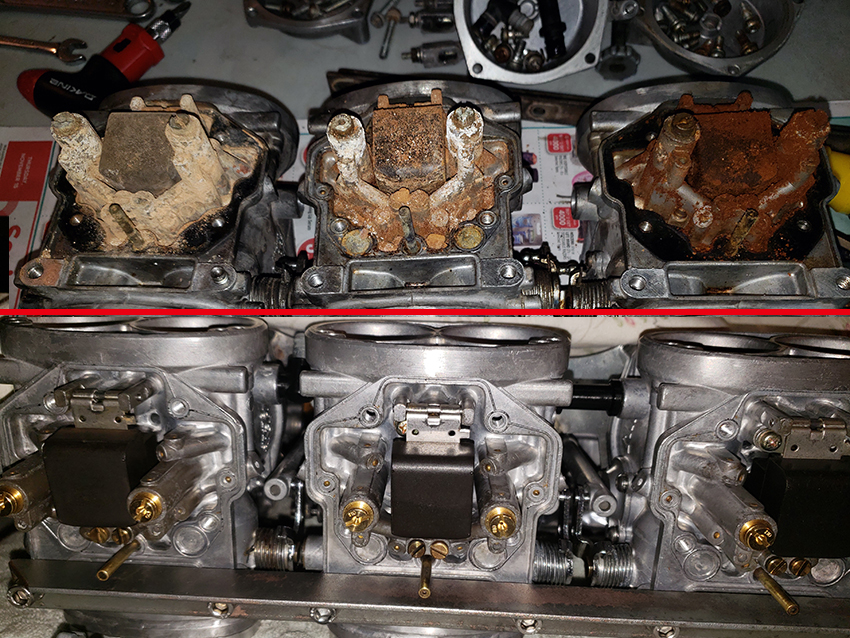

Yes, dealing with four sets of carbs purchased between 50 and 350 dollars a set. Plus shipping. A nostalgic pic now - just 5 idle jets loose left but can't get them out of one of the carb set. Blimey. Tomorrow!
Countless cleaning, lacquer thinner, scotch's tool, carb cleaner spray with nozzle, and ultrasonic cleaning. To name a few, and aftermarket parts ordered to take care of fixing when applicable.
It's been a project of mine to assemble a good spare set for my bike, then a set for the bike I am building. I will have at least two sets spare for sale eventually when ready, they will come tuned and tested on my bike. Bad parts replaced by new ones. I will abuse them for a few hundred miles before offering them for sale! haha SO there will be no gray area to ask if they work. Video included. But I am getting ahead of myself and time. I will offer complete reliable sets to mainly get some money back, when the time is right and the projects complete.

Yep, they came out with weird pliers I have, kind of looking like claws and I don't know what their real purpose is. I think cutting thick cables.
The 3 pinhead jets just sit in there loose and don't want to come out... I have no compressed air so trying to come up with a different solution. Finger turn mini 'drill' with a thin drill bit to clean them up, and a brass wire with some solder and flax, then connect, heat up and pull out? This is what I'm considering. Kind of scared of a drop of super glue in there.
Got rid of what looked like limescale where emulation tubes go and fuel supply. Gross!!! Once those float valve bodies are off, you can really see that no amount of ultrasonic cleaning would take care of it. All compacted and stuck, including weird colors. For ultrasonic cleaning surfaces need to be exposed.

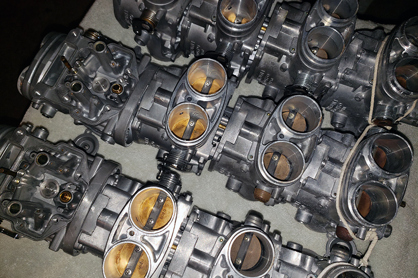

This is the same as the one in the first photo. Cool, isn't it?
Split photo.
Almost there with this sucker. Some detailing left to do before adjusting the float levels and all will be ready to be bolted up and ready for abuse by the engine lol
