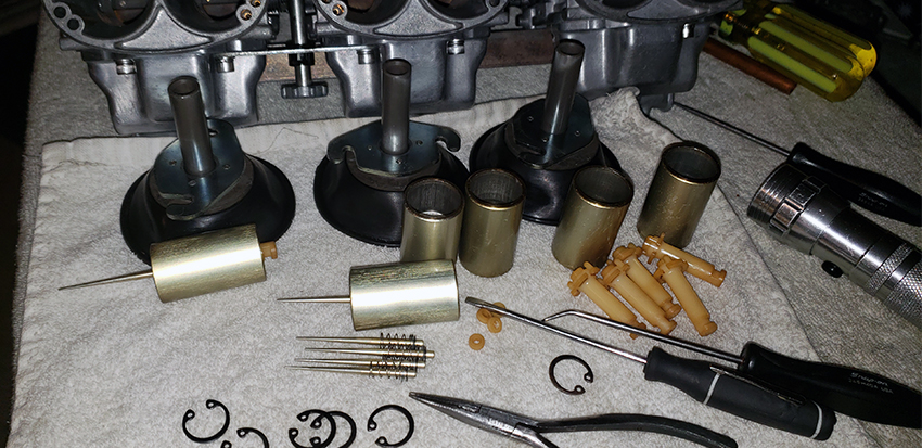

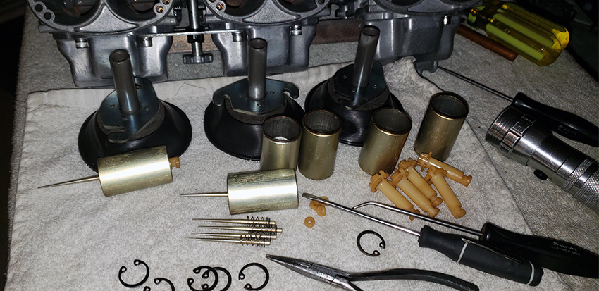

Booby trap!!! Hahaaha Beware of new parts. That's all I'm saying ;)
Trivia question - where did they come from? No shit they can plug the jets.

Aftermarket diaphragms. Took a bit of work to make them move freely at the extremes. Not the pistons! If you have sticky slides after assembly and of course cleaning - most likely you have the inner diaphragm tube aligning problem not the slides. These came in already changed by someone, and I did make them work. Best would be loosen all up and then work tightening gradually while moving up and down, but the short route worked fine here.
Just a random carb photo :)
