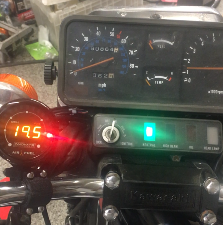

Got my carbs back together today. They were on my welding table which I needed to get cleared off to do some welding.
While apart, I replaced the O-Rings, pulled/cleaned the idle air screws (which seemed to be the crux of my issue), did the choke mod (used rivet bodies), checked the float levels (all where perfect) and bench sync'd them (set butterflies with a feeler gauge).
The bike starts well now. But idle is way lean.
The carbs are clean. They had already been "rebuilt" when I got the baskets of parts. I have taken them apart and cleaned them, but other than the idle screws never having been removed/cleaned, they where clean inside. The three little holes for the off idle transition are clean and flow well.
The AFR at fast idle (1200rpm) bounces between 18 and 20. I have an O2 sensor installed in the DG post collector/pre muffler. Tried another O2 sensor and re-ran the calibration, even though it 'acts' lean so I had no reason to suspect an O2 issue.
I have tried going +/- 1 turn on the pilot screws with only modest changes in the AFR.

I am thinking I probably just need to go to larger idle jets.
Thoughts?

Frank. No hands-on experience with re-jetting for a Bore-Kit but agree with the increase in idle-jet size. (One size up...?)
You may also find the need to raise (richen) the main-jet needle 1 notch, as well.
Your final choices/solution/results, will be interesting and informative.

Agree on moving the needle. And will see about the Main. But I am going to get the idle reasonably sorted first. Right now it has a hard time transitioning off idle, but with the idle so lean that does not really mean much.
To save me having to pull the carbs before ordering jets... is stock 42.5? These are the BN/Super BN jets, correct?
And just because posts should have pictures....
