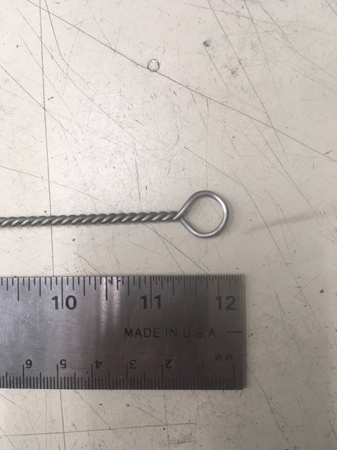

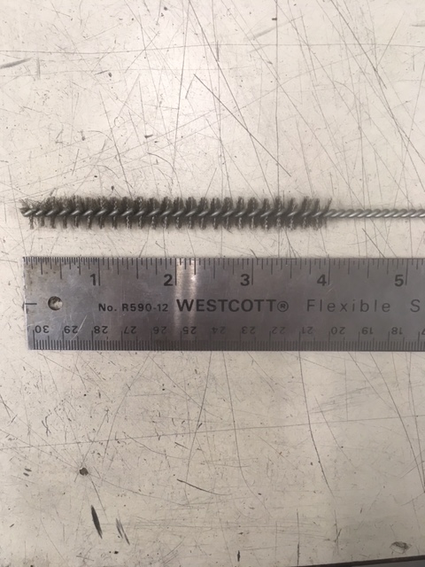

This is a typical situation where an issue - "popping and backfiring" - can be caused by one or more deficiencies. In this case, The popping is likely due to blocked and or OLD idle jets and the backfiring possibly being caused by an air-leak in the reed box for the Air pollution system as kawboy hypothesized.
Both are easily rectified. Replace the idle jets if not already done ! I've previously discussed this so won't elaborate further. With the reed boxes: remove the cam cover and block the ports in it. Blocking these ports is easy and will guarantee there are no air leaks into the exhaust. There are various ways of blocking the air injection ports (in the cam-cover !) but the easiest IMHO is done by the following: Thoroughly clean the ports in the cam cover with Lacquer thinner and a long/round wire brush. Use one with S/S or brass bristles !
If you cut-off the end-ring you can spin the brush in a drill and guarantee a proper cleaning.
Then, place some tape over each port in the cam cover on the gasket mating surface and fill with J.B. Weld High Strength Metal Filled Epoxy. I did this years ago and after 20 yrs. (?) there was no degradation of the epoxy. The cam cover doesn't get hot enough to bother the epoxy despite the ports in the cyl-head being left open. There is no need to do anything further.
This may be the time to clean-up the cam-cover by removing the "Reed Boxes" completely. Can be done easily with a hack-saw. Don't attempt to cut them off 100% flush. Leave 1/16" and file down the rest to ensure a nice finish, with no hack-saw marks in the cover, over-all. If you decide to remove the reed-box housings then you can do the epoxy treatment after their removal, which will be even easier. The advantages of removing the reed-boxes are: Neater/cleaner appearance and it makes removing the cam cover so much easier !!!!!!
hope this helps !
