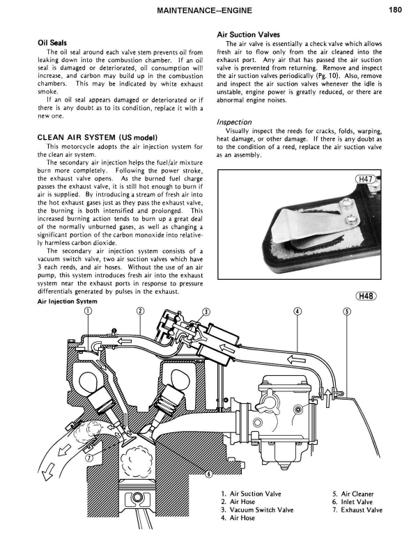

can anyone tell me what is this contraption pictured....
i think an air valve of some type.....anti pollution stuff....?
i noticed that this is NOT on my bike...
and it might be very well the reason....???

i was thinking of one other thing....
not sure....

7 years 2 months ago - 7 years 2 months agoThat's the vacuum switch valve between the air filter box and the air injection valves in the camshaft cover. The small hoses attach to the intake manifold at the ports that you would use to sync the carbs.
Page 181 of the manual describes the operation of this valve and not having it in place would completely explain why you have backfiring in the exhaust pipe. You have uncontrolled air injection .

that is one good thing - mystery solved and it maybe the cause of all my problems....just got to look and find one of these valves now.
on my bike i have two dome nuts sealing off the vents at the top case and another one sealing of the hole in the air cleaner.....
i cant see however anywhere on my bike where the two smaller left and right hoses would go.....these look to be from the photo, about 4mm in diameter and smaller than the other hoses...

Something to take into account on this subject...............
The UK / European Z1300 Model does NOT have the Vacuum System fitted, and does not have any running issues with it and cylinder head is the same.
On all the US KZ1300 Models I have owned in the past (7 + ), I have removed the system and sealed up the head plates and hole in the airbox.........never ever had any form of problems.
I have also owned six ZRX1200's including the one I have now and they all come with the Vacuum Device fitted............and everyone in the UK Owners Club removes them an seals them up.........no problems !
I honestly cannot see this is the cause of your problem, so would look elsewhere if I were you and leave the Vacuum Device off..........as its less to go wrong !
