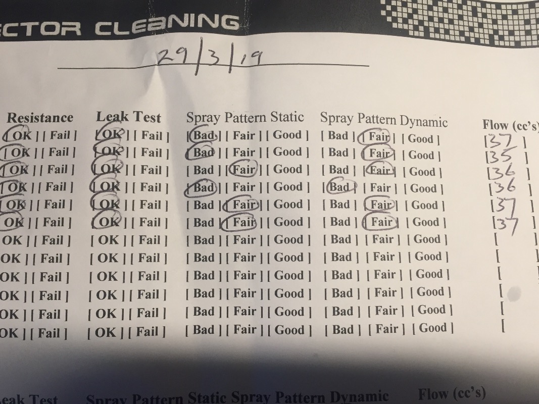

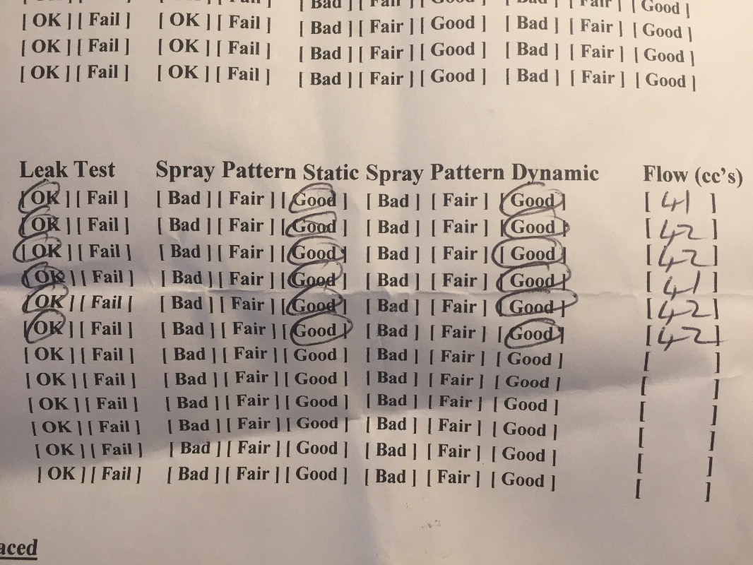

- Gavin
- Posts: 81
- Thanks: 16
Re: Replacement Injectors
7 years 2 months ago - 7 years 2 months ago
I sent the injectors off for cleaning and today I have started putting them back together, the report stated that before cleaning the
patterns were fair or bad with reduced flow, the post cleaning shows a definite improvement, need to get them back in and the bike up and running to really see what improvement has been gained.
Report results below
