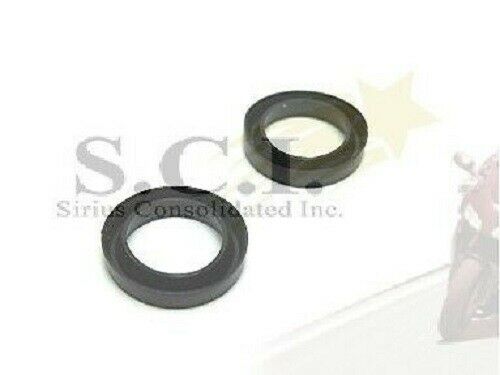

For the record those throttle shaft seals (lip seals) are
YAMAHA part # 256-14997-00-00.
They are listed for the Mikuni BS34 carbs and are the same seals for the KZ1300 carbs just no longer available from Kawasaki.
