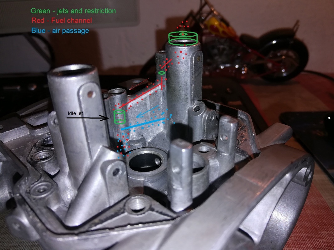

Hi Frank, Yeah it is difficult to say what PO-s do with carbs and their other mechanics to, but they for some still unknown reason are not functioning properly, maybe it has something to do with the "repair" which has been done theme or big bore kit, but i highly doubt the second one, and if yes ill be surprise. One thing is hoever possible, that the charge delivered to the cylinder by carburetor can be leaner due to air volume being sucked in is larger but rejecting the carb must still cause expected behavior, in the case of BSW32: bigger idle jet = more fuel = richer mixture. That's my experience at least. Any remote diagnostic of carb with passages as small as 0.425 mm are extremely difficult and my language barrier on the top of that, so i made the picture how the fuel is going past the main jet than the idle jet and than is getting mixed up with air after the idle jet, creating "mixture". Like Scotch have said: The idle screw only meters the volume of the mixture not the proportion of fuel air, that's very important t understand.
Lastly I'm sorry about the childish made picture but like i said the language made the thing more difficult to explain for me and also if you see this is probably better anyways. So once again the idle jet meters fuel only, not the air. The symptoms could indicate that the fuel is being pushed back away from the idle jet towards main jet, thus creating idle mixture leaner and when you change the idle jet to smaller size so the effect is less. Hmmm.. could be.

That's the troublesome restriction in this carbs, not the hole it self only how the gallery is pointing up towards the fuel exit and so the debris and rust particles are settling down there.
