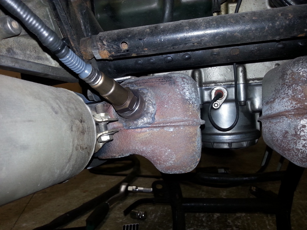

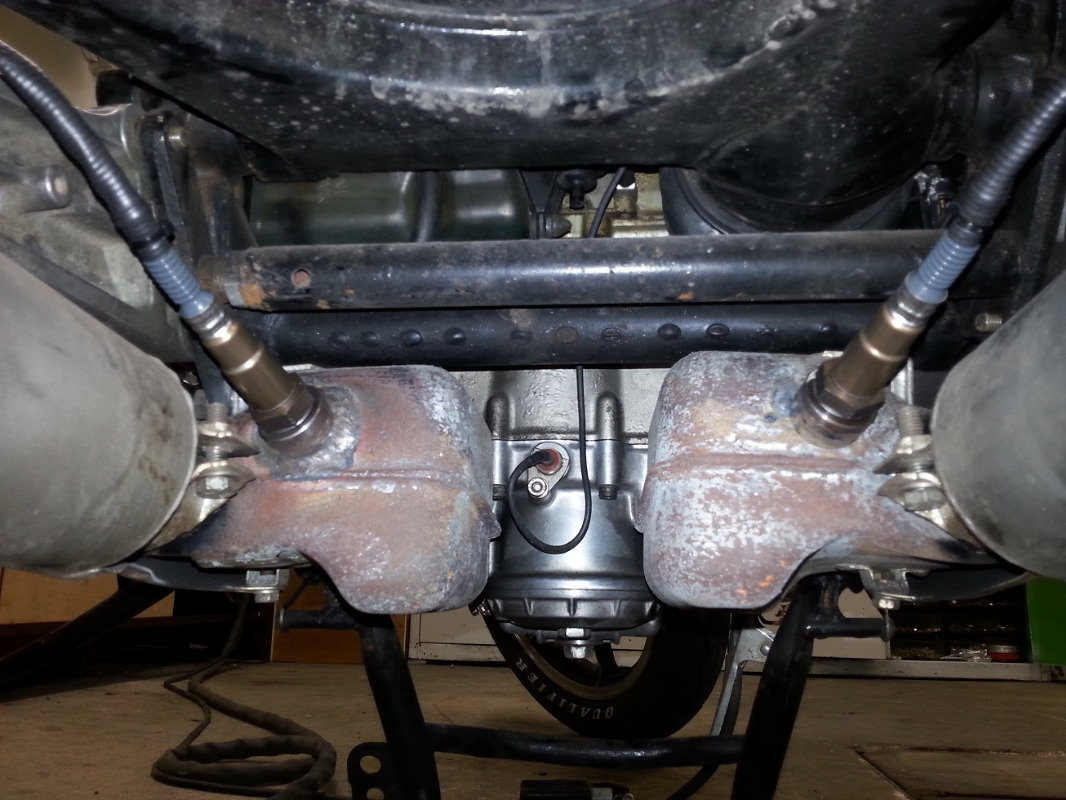

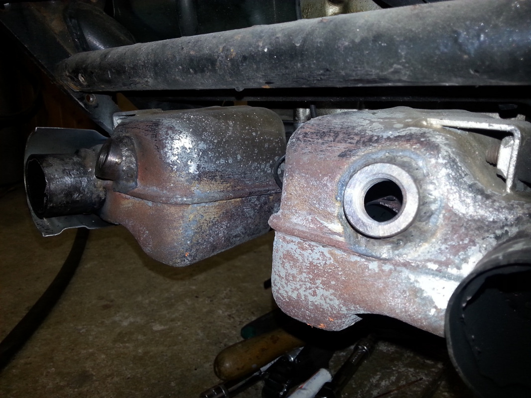

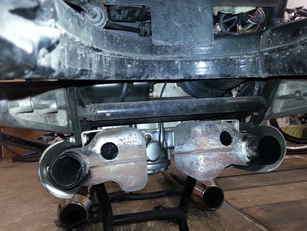

Here is how i have installed afr gauge and the lambda sensors to make carb adjustment and rejecting easier.
First the holes for the bungs
And some welding done too.
After that another side
Warning if you do that like i did it is important that the lambda sensors don't collide with center stand when you push the bike off of it. Like it happened to me when i was ready :S .

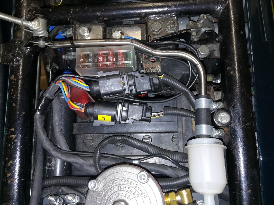

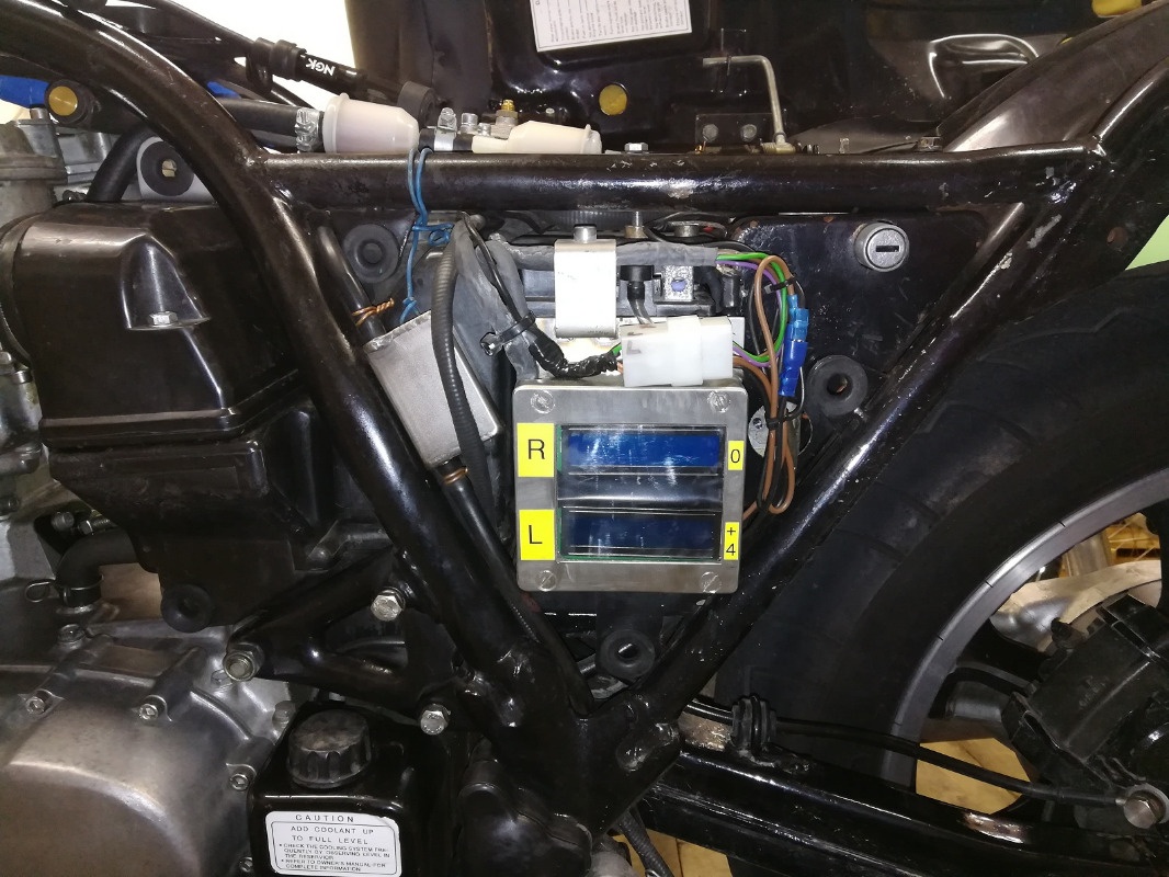

Stan i got the controller for lambda on the left hand side
This are Sigma Lambda Controller Free 2 from 14point7. each for three cylinders so middle card is shared.
This is where the connectors live.

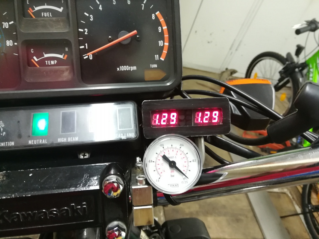

And finaly the gauge.
!!! VERY IMPORTANT !!!
Looking at any gauge or display of any sort while riding can cause accident, severe injuries or even death, so i take no responsibility for anything. Personally i use this only when the bike is stationary, and the device is off while riding.
