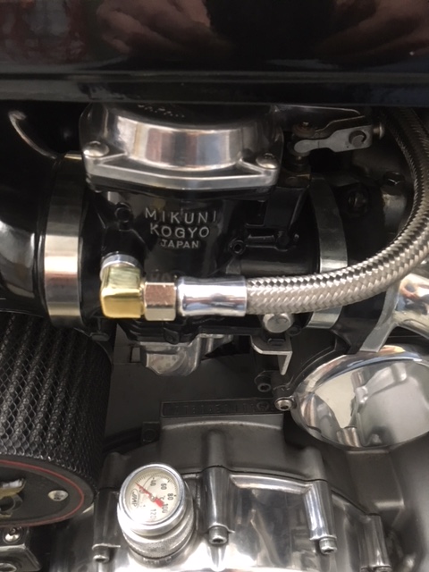

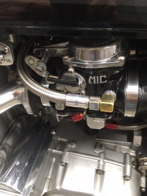

Evening all.
Any recomendations on perfect fuel line route. I have found a lot of my issues are fuel line related. With a seperate bottle hung from roof to carbs she starts and runs much better than with tank.
Tap is free flowing and no solenoid. I think the fuel line is routed wrong, but whats best to keep fuel flowing. It looks ok but there is some issue?

Fuel-line routing - My pet peeve !
From the shut-off valve - thru a small filter and continue to and around the right-hand carb. Then behind the right and center carb to the Fuel-T. Adjust the Tee accordingly but try to keep the Tee as horizontal as possible. The fuel-line is now (should be) horizontal and that's the key point.
