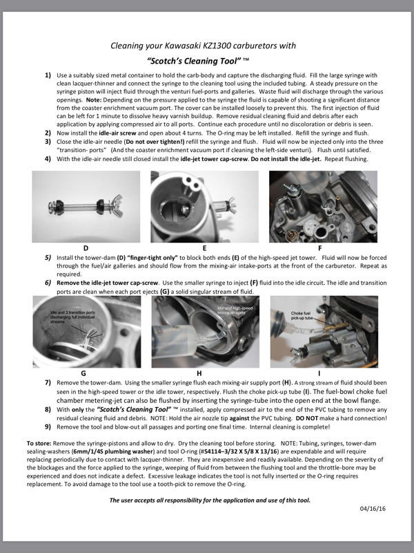

I've rebuilt 400-500 carbs over my lifetime and I can honestly say that I've condemned several carbs as being not rebuildable because of a fundamental lack of knowledge on how to properly clean the idle circuit. Through reading Scotch's carb rebuild topic (pt 1) I figured out what I was doing wrong. I invite you to spend some time reading the topic I have linked here for you.
kz1300.com/index.php/forum/carburators-f...rebuild-pt-1?start=0
Due to the problem of cleaning the idle circuit on the Mikuni carbs we have, Scotch designed and sells a "Cleaning Tool" specifically for cleaning the idle circuit on these carbs. Many members have bought the tool and report great success after using the tool. If you are interested in buying the tool, send Scotch a PM (personal message) with your personal email and address. He will reply with a cost including shipping to your address.
If you would like information on the cleaning tool, read the link here
