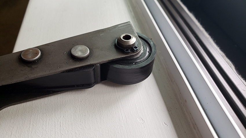

My gut instinct says that the cam chain tensioner bottom roller has disintegrated. The black plastic like particles are from the roller and the metallic bits from the needle bearing / housing underneath the roller body.
My roller broke down a year ago and I had to replace it, the mess in the pics looks very similar.

I agree with you Lare at this point. I think Idemon should revisit checking the engine from the top. We mentioned before the tensioner and guides, and he said he checked all after removing the cam cover and all looked good. But it makes me wonder if he knows how exactly things should look, so perhaps he missed something.
Idemon, I'd suggest digging in again with your camera piece. The roller of the tensioner is right behind the cam chain tensioner and is facing the inside of the engine, so you'd need to do it from the top through the cylinder head (it's directly below the nylon sprocket, at the other end of the metal piece that sits below it).
For reference, this is what you are looking for. The cam chain should be sitting on the roller - the tension from cam chain tensioner is applied to the chain with this roller.
If it's messed up (in this case would be more like missing), the cylinder head must come off. It's much easier than swapping the engines.
