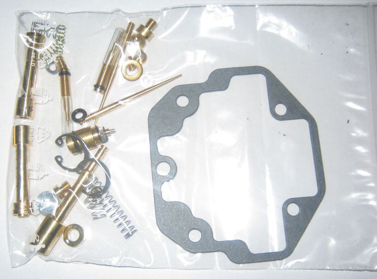

P.S. i'll add a photo of a carb kit I got so you can see the parts, perhaps seeing them will aid you in pulling them out ??, the "tubes" that are part of the main jets, the bit the needles slide into are in firm, not really hard, they pop out up towards the needle and press back in, had to just give them a bit of a tap.
Kit :-
