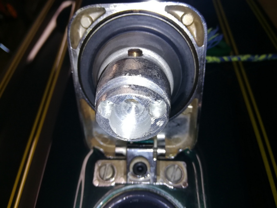

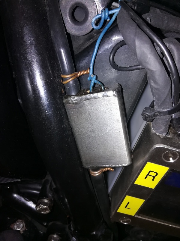

Hi Pete, yeah i know this problem. In my case when the fuel tank was warming up from the engine, the fuel was gushing out of the vent pipe like crazy under the bike, also from the hole where the key goes in. I have rebuild the bottom part of the cap to stop that, unfortunately i don't have detail photos of that. Now the vapor pressure cannot push the fuel up because the hole to the venting mechanism is so large that the fuel cannot stay up there because its gravity. It may not be the solution you like but for me it works, also to make that it was a lot of mucking about, yeah i don't even know if id go this rout again. Also to see if fuel still comes out thru the venting system i have build the small trap for it. Here some pix.

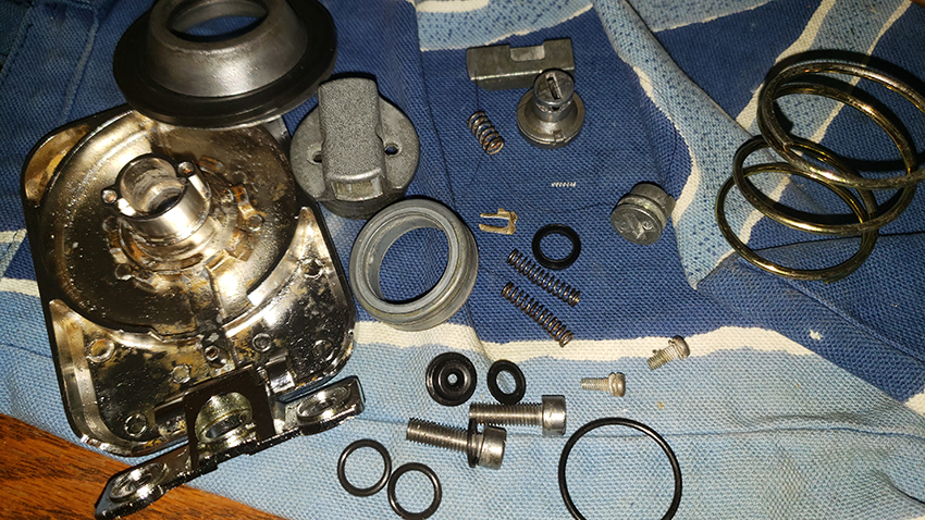

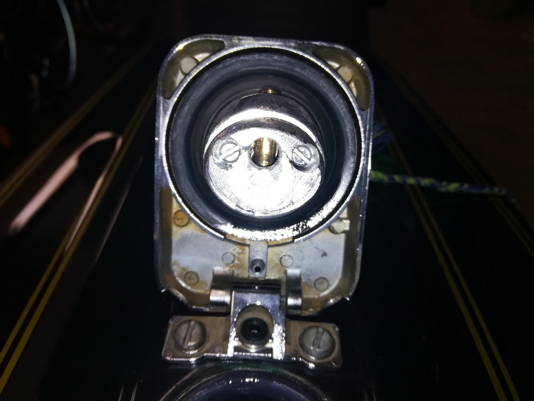

The inner drum of the key lock of the cap can be removed - very gently with a very thing screwdriver (the latch/key holding it is in the middle in the pic) if you depress it (very small tiny spring there behind it). There is an o-ring sitting on the drum that can be replaced - it seals the drum from leaking gasoline through the lock.
You must be very careful when disassembling the fuel cap as there are two paper thin and brittle gaskets there, most likely fused to the bigger round part (left next to the latch).
Different fuel caps have slightly different designs. The biggest difference would be some have one some two springs in the key mechanism.
