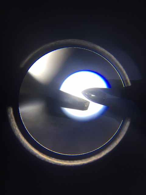

The photos will save a lot of words. The needle on the right is stock (damaged) The tips on these are machined squared-off. The modified needle on the left has been was re-profiled - shorter to remove the damaged surface material, and pointed......which was the objective of this experiment.

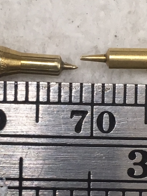

A better look with the new profile cleaned-up.

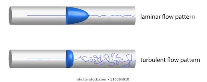

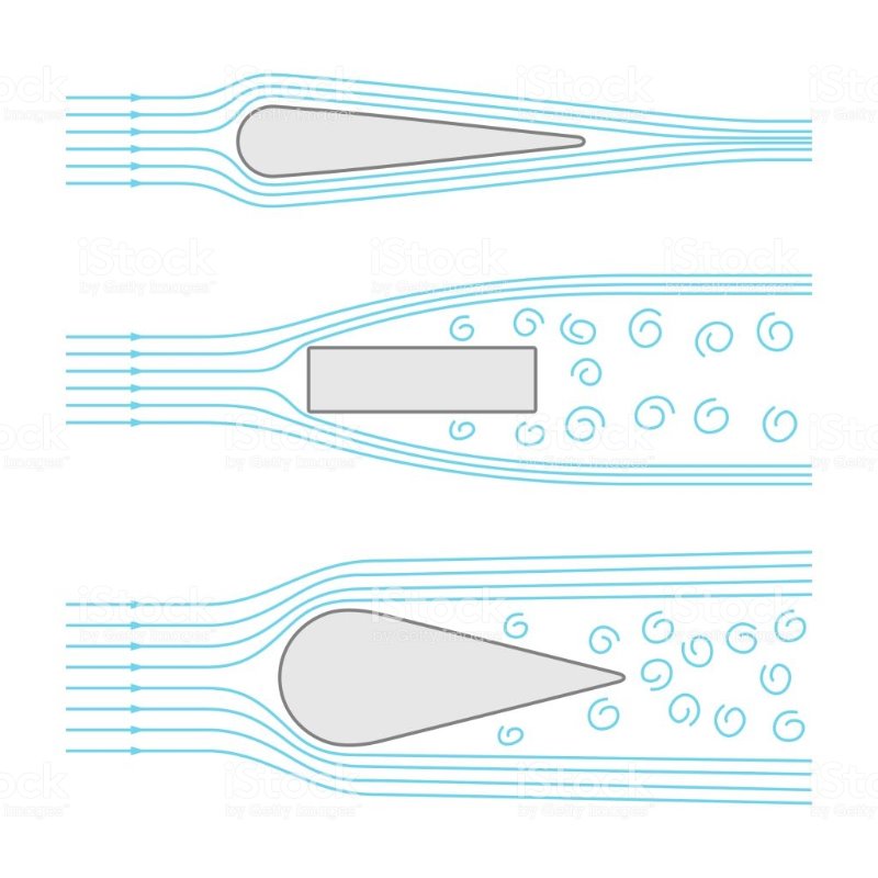

The theory:
The results were: Now shorter and with a steeper angle the modified needle has a narrower range of adjustment, relative to a stock needle. 2 turns + or - 1/8 turn. An unexpected benefit was with regard to "Color Tuning" The range of the "Blue" is now less then 3/4 turn, making using the Color Tune far more definitive in finding the "middle" of the Blue range.
The theory:
