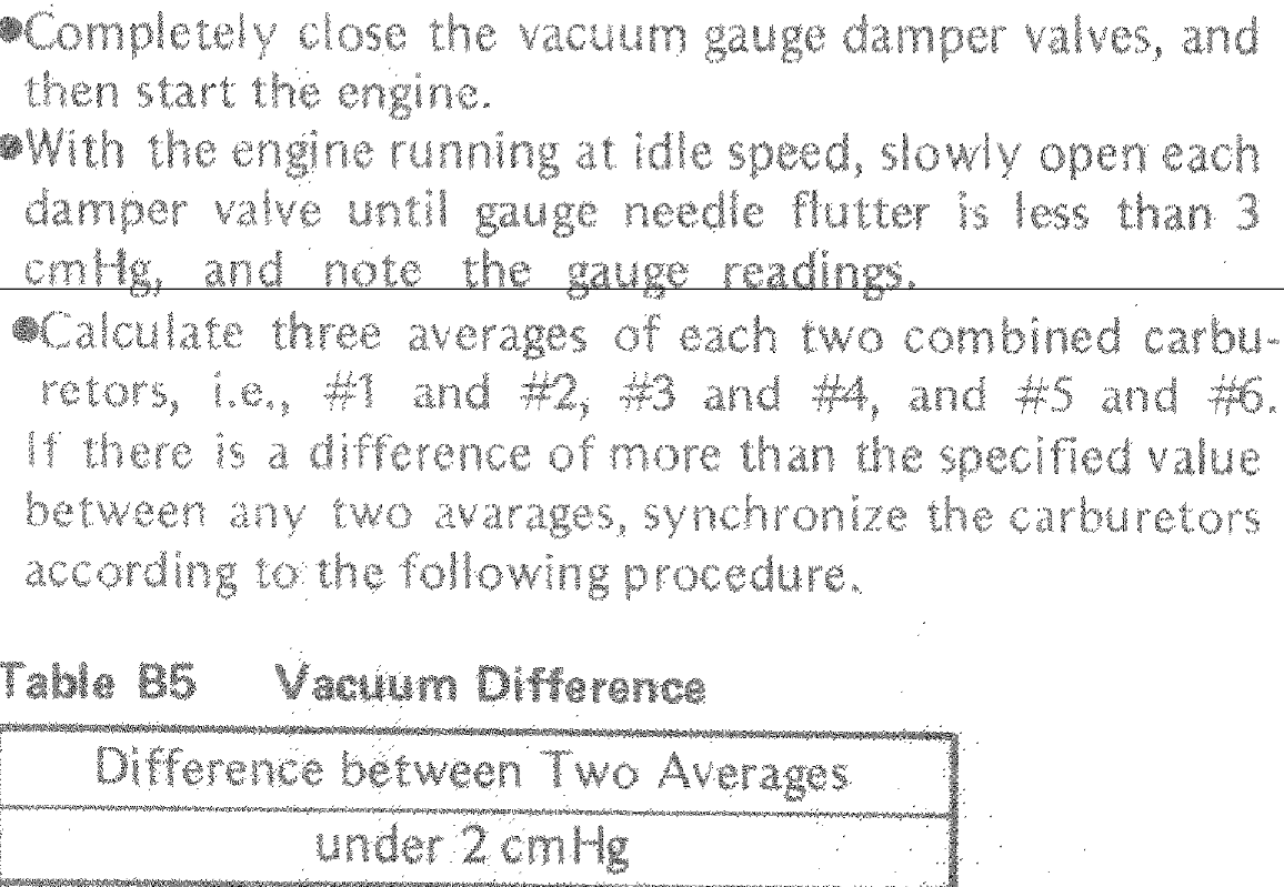

From the manual:
This should be stricken from the manual.
#1 - The gauge needles can not bounce around !!!!! Period ! And certainly not "less then 3 cm". Pack cotton into your intake manifold adapters and keep cramming it in until the gauge needle reads without "bouncing".
2) Forget "Averaging". With a correctly dampened gauge and understanding your compensation factors you can achieve sync. to within the width of the needle points across all three. This of course requires patience and a fine touch on the adjusting screw and lock nut.
This will deal with the issue, if the issue originates at the sync procedure..
