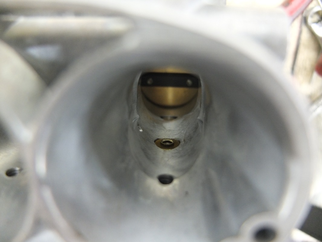

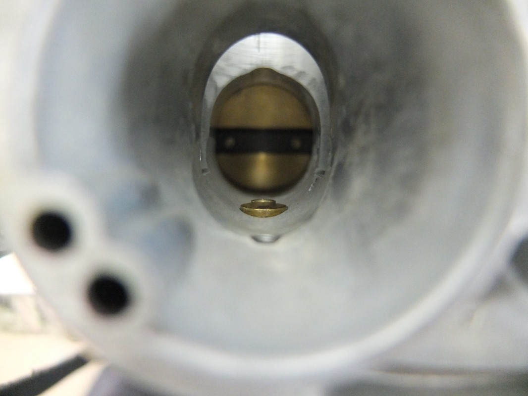

Laszlo: In this picture, The Emulsion-tube is sitting correctly in the venturi
In this picture - presumably after the addition of the O-ring, the emulsion tube is sitting too high and the disruption to the air flow may have an adverse affect on the fuel draw And the additional height is also going to create a very lean mixture throughout that fuel delivery range......in my opinion

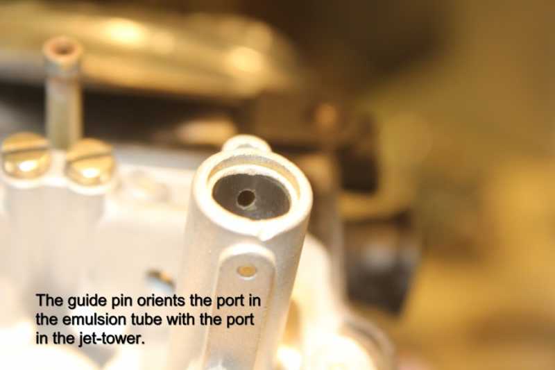

Of Equal (Great concern) is related to the change of height of the newly o-ringed emulsion tube and it's alignment relative to the fuel port that delivers fuel to the idle circuit. It appears to me that they will no longer align thereby restricting/preventing any fuel from being delivered to the idle circuit.

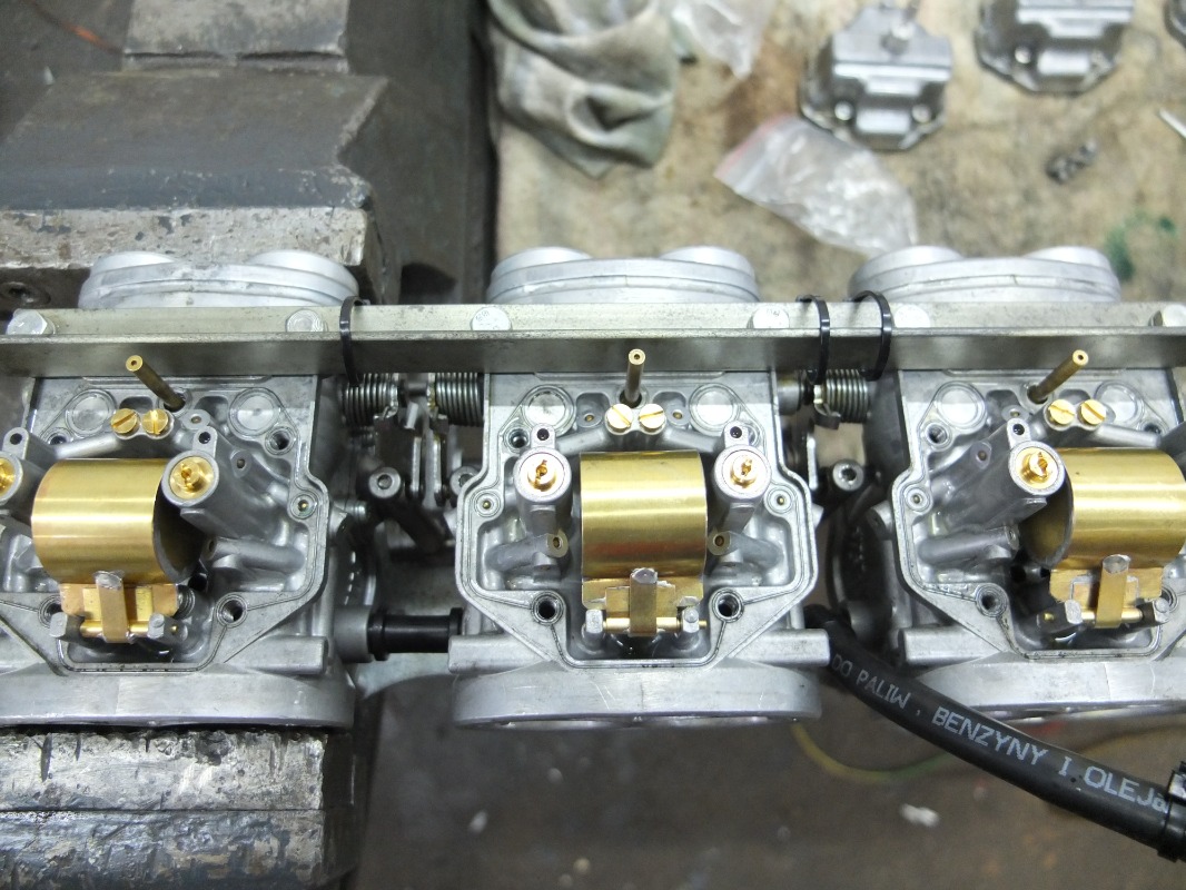

I can see the fuel line was made in Poland. It says 'for fuels, gasoline and oils'!

No no. The o-ring is not placed under the shoulder but on its side. So it doesn't hold the tube. This image was taken when the tube was not in place. See the other picture. The two pictures were made just to see when the tube is in place. On my atomizer, the factory small shoulder is not sealed at all. The main nozzle should not be tightened enough to seal the shoulder.
