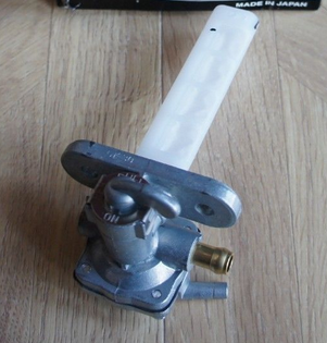

Mizz,
Thank you for your reply.
Looking at the tap you have fitted as seen on Ebay, the petrol pipe nozzle is in the wrong direction to the original tap (as seen in the Ebay photo below).
The original tap has the nozzle facing BACKWARDS (as seen in my earlier photos) towards the middle of the carbs and your tap has it facing the the RIGHT.........towards the rear of the bike. ??
Can you please take a photo of your tap as fitted to your bike........I would like to see how it looks and works and how you route your petrol pipe to this tap. ???
Thanks again.

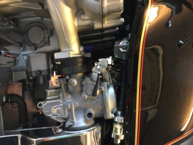

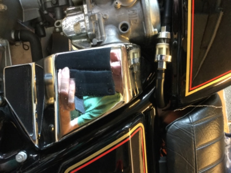

Hi Pete,
I put a in-line filter on as an added precaution. If you omitted the filter there would probably be enough room to route the fuel pipe in front of the down tube instead of behind the tube like I have.
