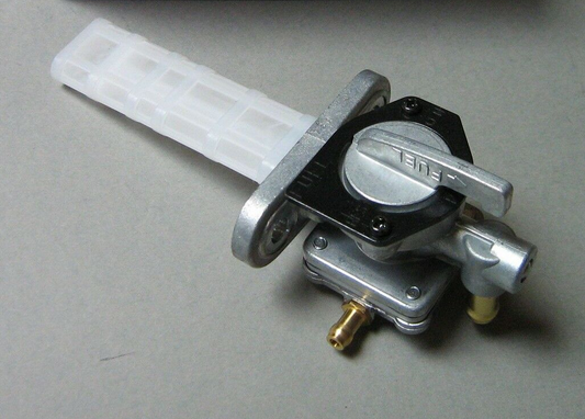

Any chance you can post some pictures of that fuel tap? Curious if it's an option for a ZN1300. I don't need one presently but wondering for future reference.

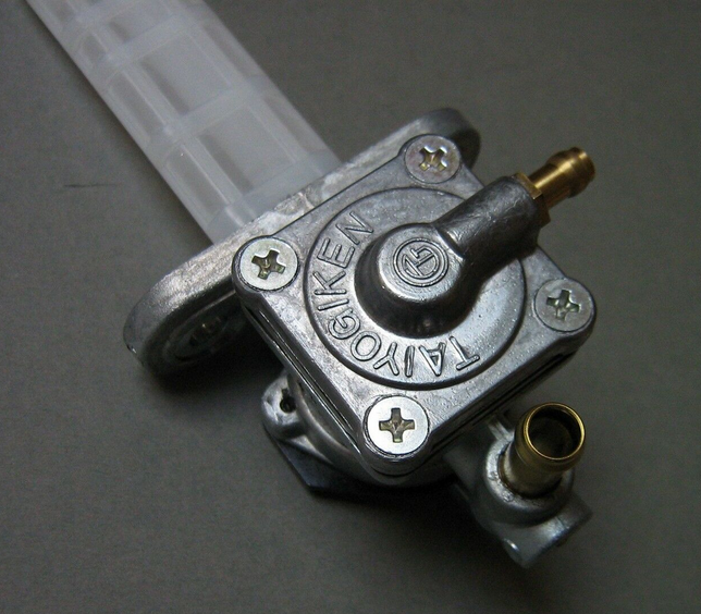

Here you go !
GPZ900R Petrol Tap.
Has the same hole Centre to Centre as the Z/KZ1300.
You can remove the rear vacuum plate and re-fit with the vacuum pipe in a different direction.

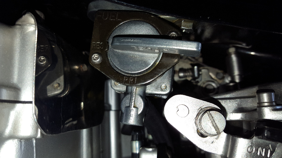

One of the photos is the same tap fitted to my current Z1300.

GPZ900R Petrol Tap.

The issue I have is that if I leave the tap in PRI (Prime) position, the bike runs great at all RPM and speeds, which shows the tap has the capacity to feed all 3 float bowls enough fuel..................but when in the ON position, its all good generally until cruising at 70 mph or higher for more than 5 minutes or so...............then fuel starvation kicks in............so turn to PRI and all good.
I have tried the widest vacum ID pipe possible, but its obviously restricted by the vacuum spur on the tap and on the inlet manifold.
For the life of me I just cannot recall what set up I used on my last 1300 six years ago as that worked fine.
