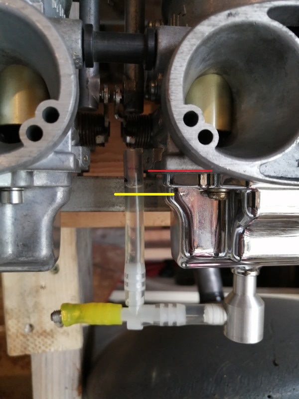

So I check my float level and. It look good. So I change sparkplug 5 day ago and did 60 KLM park it after that little and Smoot ride. Stay park for 5 days and today notice the fuel in boot it like 1 or 2 ml not a big amount. That's my float level.

If your measurement as indicated by your tube is 7.5mm from the base edge of the carb body , then you're OK. However, going by your picture it appears your fuel level(s) is too high.
