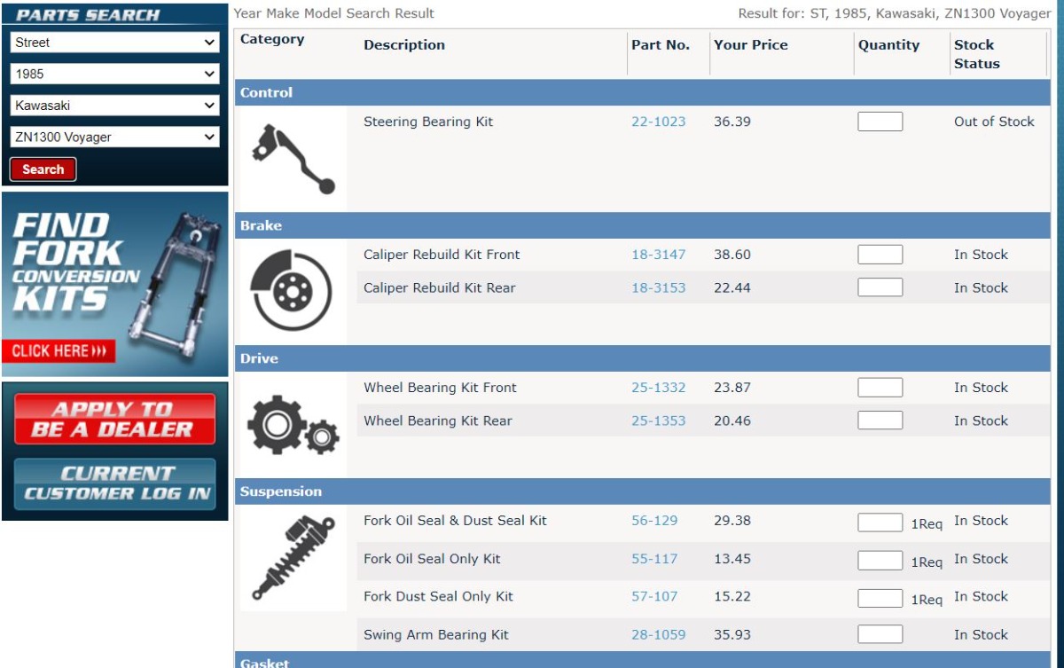

You can try All Balls Racing
www.allballsracing.com/
below is what they have
I found rebuild kit for master cylinder on ebay
as much as I remember the rear was hard to find
you can buy a new for around $15, probably not the best quality
or used from newer model, they are easy to find
if you need help with that let me know and I will find where I got them from
