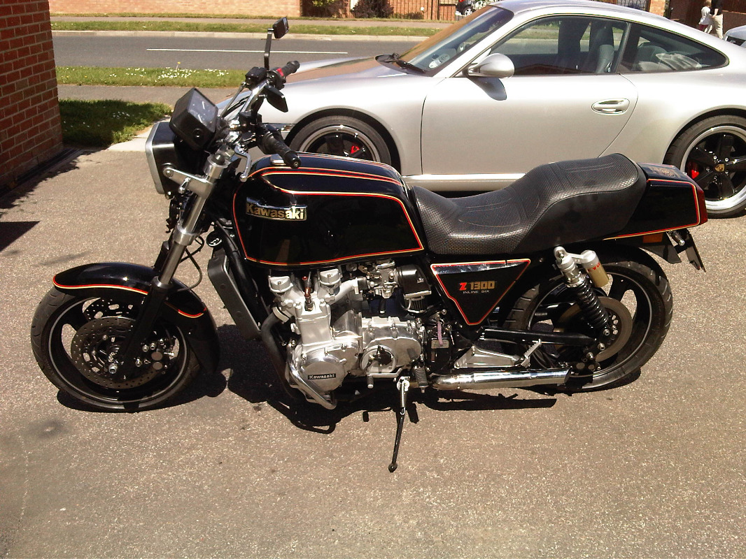

Paul,
I have ran a Z1300 with similar filters to you (3) and straight thru pipes and it was ok on all standard carb settings (see pic of bike below) so I think its maybe a set-up issue you need to play around with.
If it runs ok on main jet (above 1800 rpm ish') but not below that, then it is a primary carb setting issue.
The earlier suggestion to set your 6 mixtures a further 1/2 turn OUT maybe a good starting point...............
Pete F
UK
