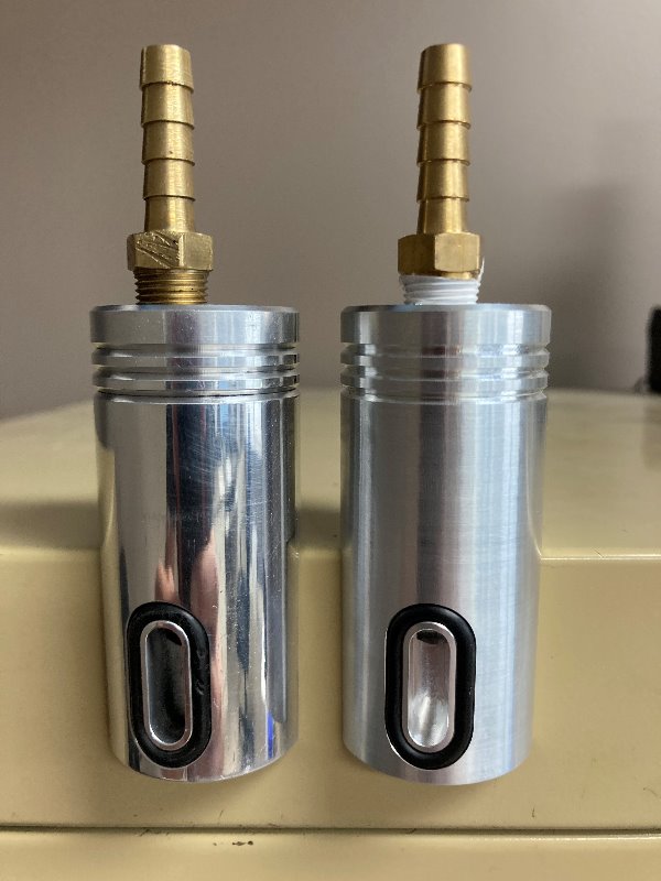

Discovered the other day while cleaning a set of carbs that the patina in the venturi's of this particular set, was really making the tool difficult to remove. Even with handle attached and a light film of oil applied.
Wondered if polishing the Tool, would help.
It did.......with a remarkable difference in ease of removal !
