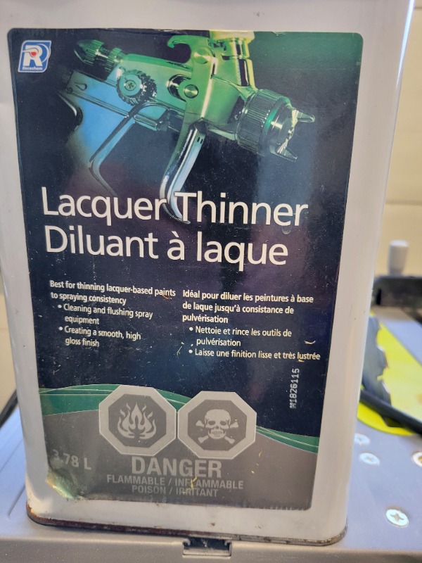

So why are we discussing Lacquer Thinner here on the Forum? One of main problems we seem to have is that “Lacquer Thinner” is not available in parts of the world and we keep getting questioned on this Forum for other names of the product or other thinners that will do the same job for us i.e. cleaning out our carburetors. Cellulose thinner has been suggested several times and yet cellulose thinner as near as I can tell is not necessarily the same. Acetone has been suggested as having similar solvent properties and able to be used for our cleaning purposes. What I can tell you is that Acetone has a very fast flash of compared to the Lacquer Thinner I use for cleaning.

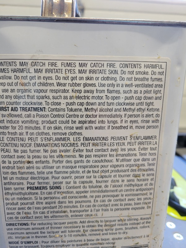

I've included pictures of the Lacquer Thinner I personally use and the second picture shows the chemical composition although not the specific percentages of each of the chemicals. As a solvent for cleaning the gunk/ residue in our carbs, this one works. I'm hoping this will help all of us better understand the name Lacquer Thinner and maybe help those in other countries with the procurement of similar solvents for the purposes of cleaning your carburetors.

that's the lacquer thinner I use. For cleaning carbs it's the only solvent I will use. Works magic with The Cleaning Tool.
